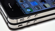

Bu,Bu,But Thats an iPhone 4. Is the iPhone 4S different?
How do you know that is an iPhone 4S or a 4?
You don't..
also that's what she said.

Count the bands. The image only has three.
The steps are the same for the iPhone 4 and 4S.
Fff- I forgot to count them I was hoping to get off easily. :>
I am confused. On Verizon iPhone 4s the antenna break in the band is also above the mute switch as well.
The 4S psychically looks identical to the Verizon iPhone. But it has FCC logos on the back. The Verizon 4 does not.
But the one in your image above, doesnt have the break above the mute switch, therefore, its a 4. NOT a 4S. Thats all Im sayin'.
Top is CDMA. iPhone 4S has CDMA antenna breaks but also has a SIM slot.

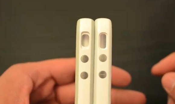

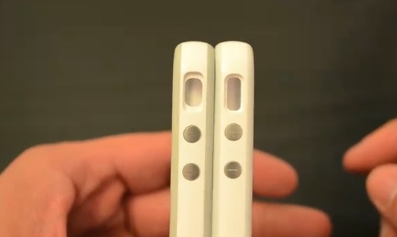

I have a bumper on mine. You just have to be sure it's one of the universal ones that fit both the CDMA and GSM 4's.
Cool. I tried to be smart and bought two extra bumpers just before the 4S came out (thought it was going to be exactly the same as the 4 and wanted to have a new bumper on the new phone). Oh well, not far enough off to make it a loss. Im still happy.
Which one is it? You want the one on the right.
Your bumper is going to get so dirty. I can't stand bumpers anymore, they're good for the first couple of days but after that they get so gross.
Thats why I get black. So I cant SEE the grossness. 🙄
Ill look for the *right* bumper once the ones I just but go bad. now I know. thanks
