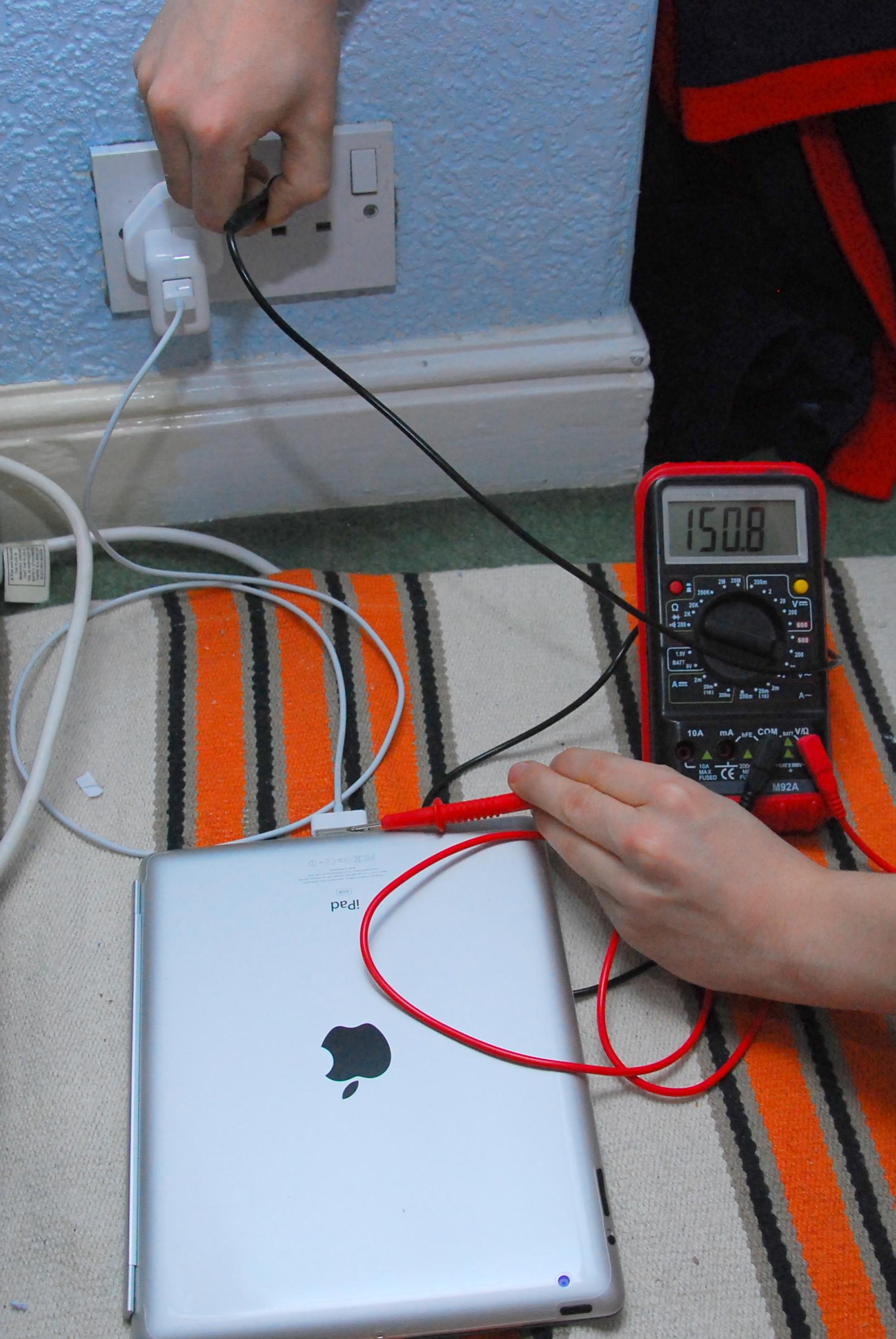

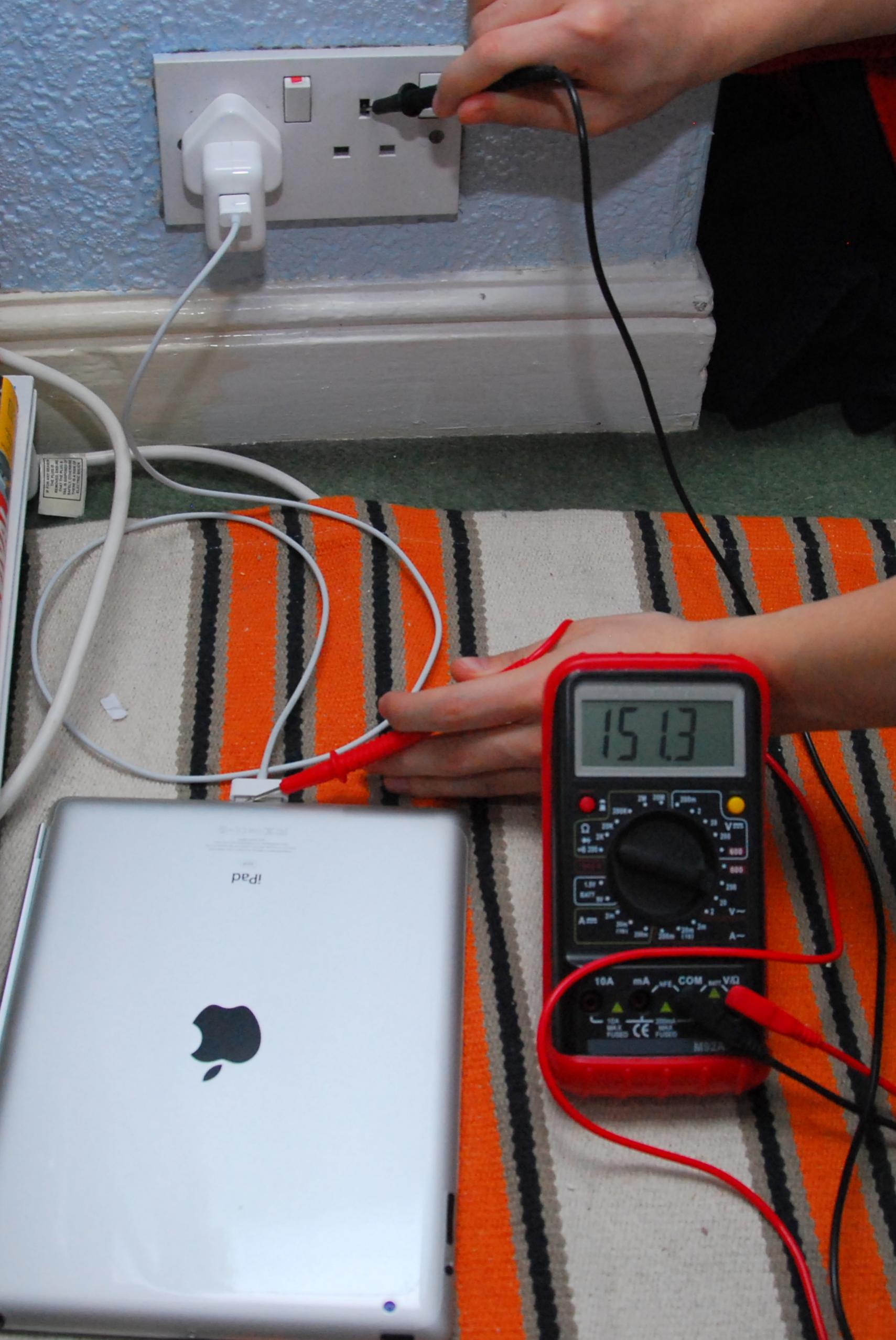

I checked between the little bit of the dock cable which touches the apple aluminium case and the earth (direct on Wall plug)

Just got my multimeter out again and I recorded 143volts AC and then with amps that is not even showing up on my multimeter (so low) on the iPad official charger.
Then I tried again with the iPhone 4 official charger and recorded 31 voltsAC
This was between the earth on wall plug and dock connecter on iPad/iPhone. This is just strange and worringly safe?

Can you take a picture of this, with the setup complete, for me please?
Thank you very much 🙂
recording 150volts+ ac between ipad dock connector and earth on wall heres the picture @ct2k7
