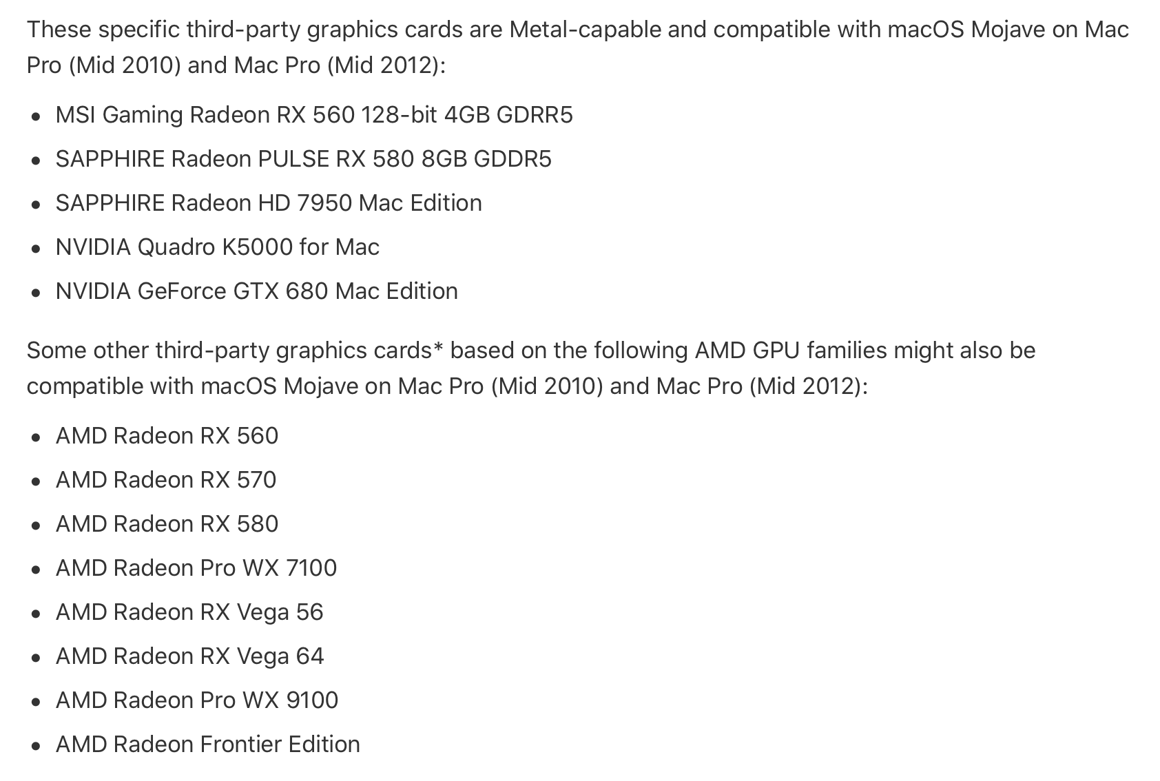

GTX680 is natively supported in Mojave, driver included.
Only the most basic functionality works in Mojave. There is no acceleration. You can read all about this issue on the TonyMacx86.com site. It persists not only with Macs but with Hackintoshes as well.
Apple said GTX680 is supported, and it is supported. Try it yourself.
https://support.apple.com/en-hk/HT208898
Agree, this is why it puzzled me why there is no video acceleration in Mojave and only applicable to '3rd' party apps, while Safari can utilise the GPU for the acceleration.
Thought I do think the Apple driver might not be as complete as Nvidia, but video acceleration do work under Safari, it just that VLC, Chrome, mpv they all failed to initialise the video acceleration.

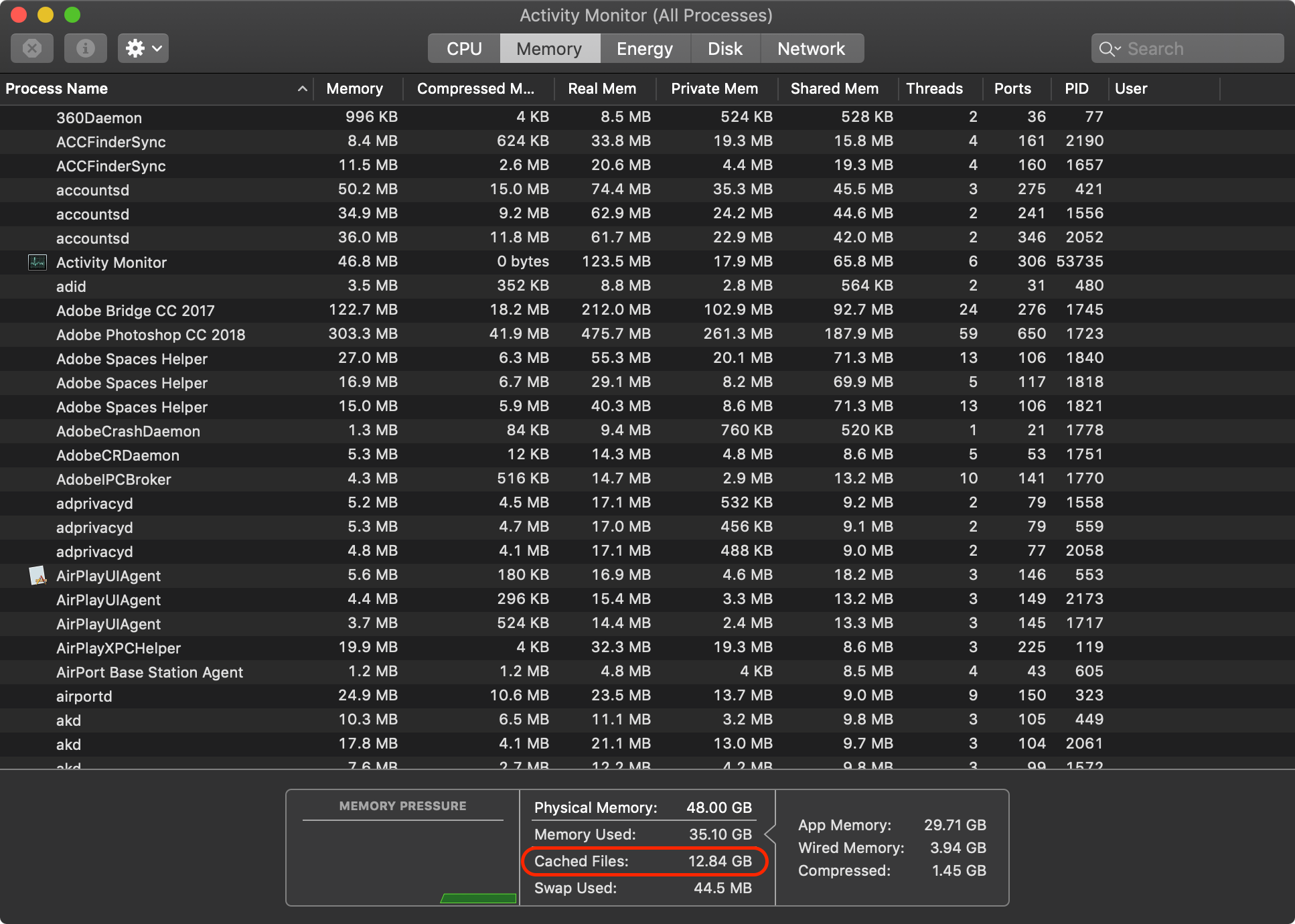

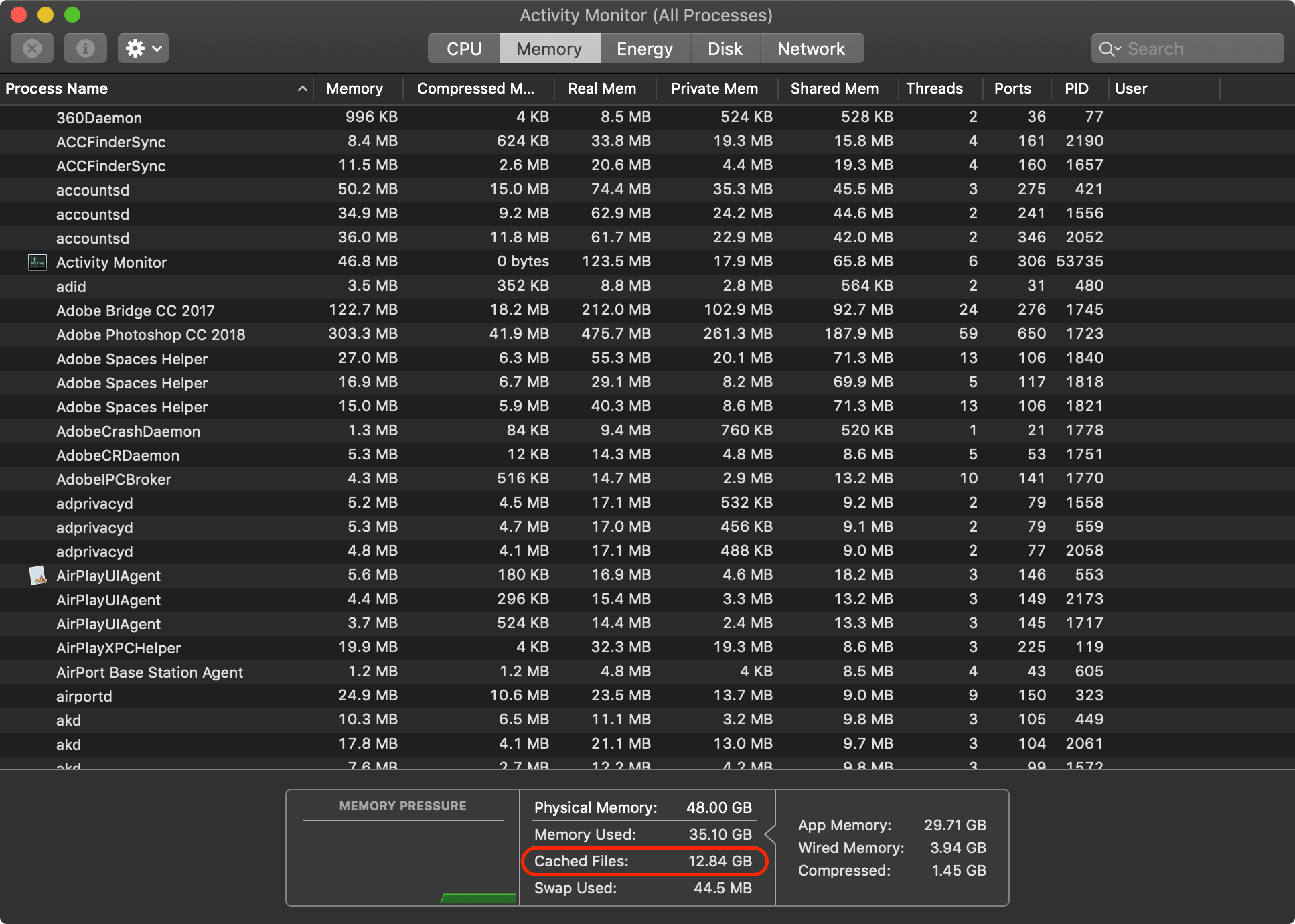

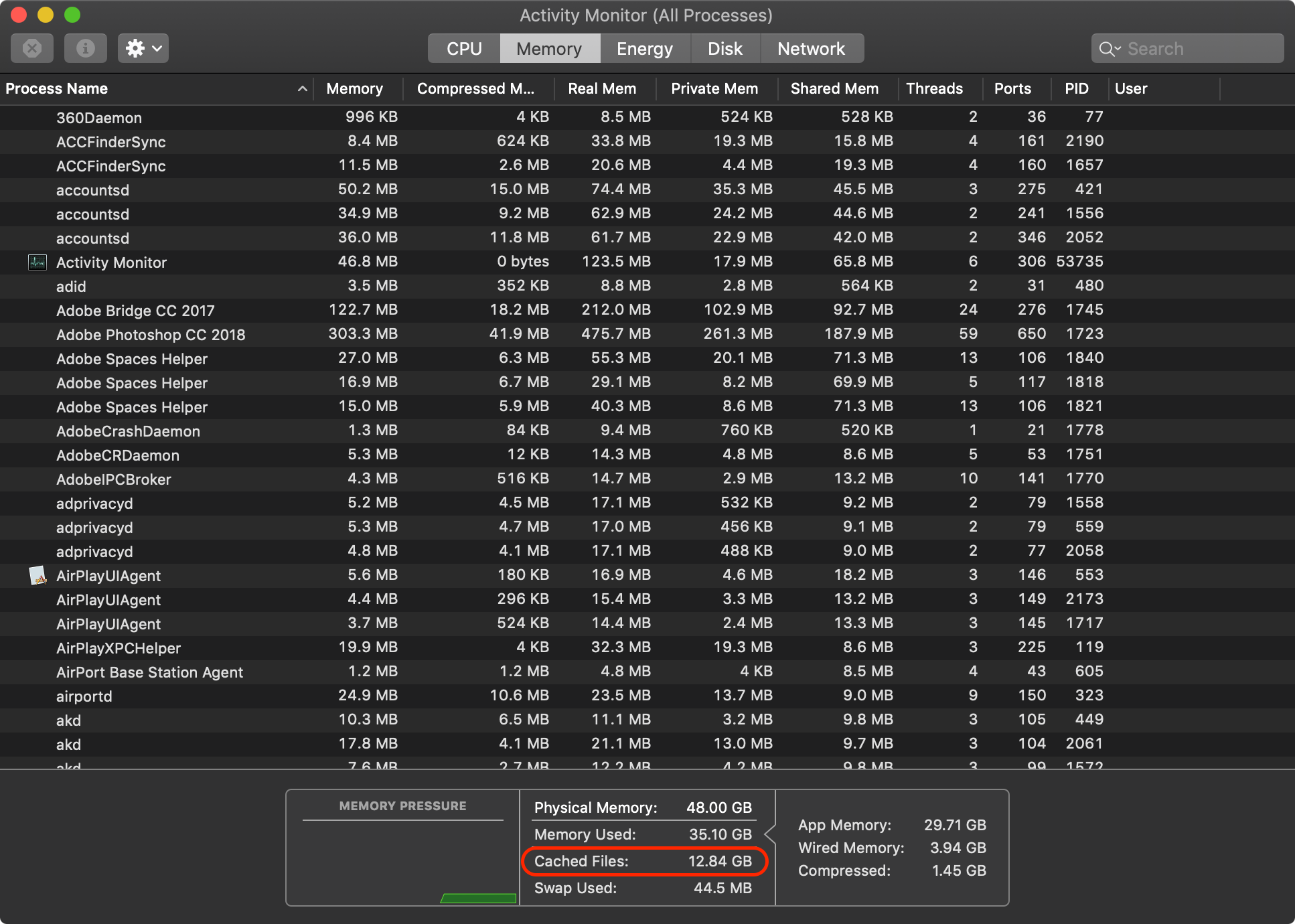

If you have TRIM enabled, that amount of log / cache is virtually nothing to a modern SSD.
For normal usage, a SSD can easily last for 20 years. By that time, you should able to easily get another one for much lower cost with much higher performance / capacity.
AFAIK, Mojave changed some cache location, which makes some RAM drive software use RAM disk for cache at this moment. (e.g. iRamdisk). But your manual way should work.
I tried RAM disk cache before, can't feel the difference in speed. The data that OS required to load are stored in the RAM anyway, until run out of RAM, those "cache" are always there. I just check my memory usage, 12GB cache files is there. Let the system to decide which data can stay in the RAM usual provide better performance.
So, unless you can clearly feel the difference in your workflow, there is no need to use RAM disk cache to reduce SSD wear.
