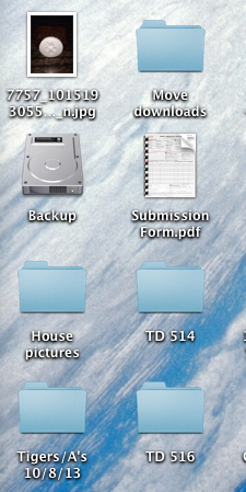

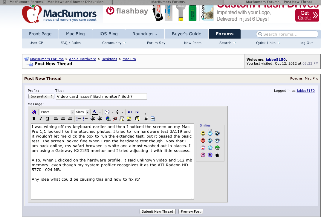

I was wiping off my keyboard earlier and then I noticed the screen on my Mac Pro 1,1 looked like the attached photos. I tried to run hardware test 3A119 and it wouldn't let me click the box to run the extended test, but it passed the basic test. The screen looked fine when I ran the hardware test though. Now that I am back online, my safari browser is white and almost washed out in places. I am using a Gateway KX2153 monitor and I tried adjusting it with little success.
Also, when I clicked on the hardware profile, it said unknown video and 512 mb memory, even though my system profiler recognizes it as the ATI Radeon HD 5770 1024 MB.
Any idea what could be causing this and how to fix it?

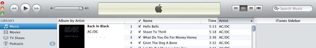

Here is another screen shot. My safari window is white and almost washed out. Everything on my desktop is practically glowing. I did not knowingly adjust any of my settings, but they did not look like this earlier today.

The last attachment is the top of my safari browser. It is white on my screen and, where it says reader, it is unreadable. It is not the brushed gray anymore. Here is the top of my iTunes window.

You have posted 4 screen shots, which don't show your problem at all.
All we have to go on is your description.
Seems likely that you may have accidentally pressed the "wrong" keys that changed some of your screen settings.
Go to your System Preferences, then Universal Access. Check that "Enhanced Contrast" is adjusted to normal (should be all the way to the left)
That would be the Accessibility pane after 10.8, I think.
That fixed it! Thank you so much! It was cranked up almost to maximum and was SUPER bright over here. I know I was wiping the keys around F12 and F13, so maybe that somehow changed it.
