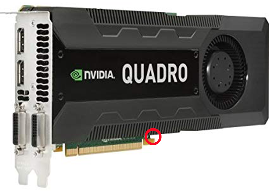

can you post a photo of your GPU or a link to it online (the same model you have if from online)?
Sure. The card I have does not have a serial number barcode sticker on it. Here's a pic from Amazon. The only difference on my card is the removable tab portion shown circled has not been removed.

cool wanted to check it was not a funky card, that's a legit one (there's been a lot of fake GPU's but that ones real 😀 the fake ones look fake idk why people get them, the fake ones show wrong vram sometimes)
