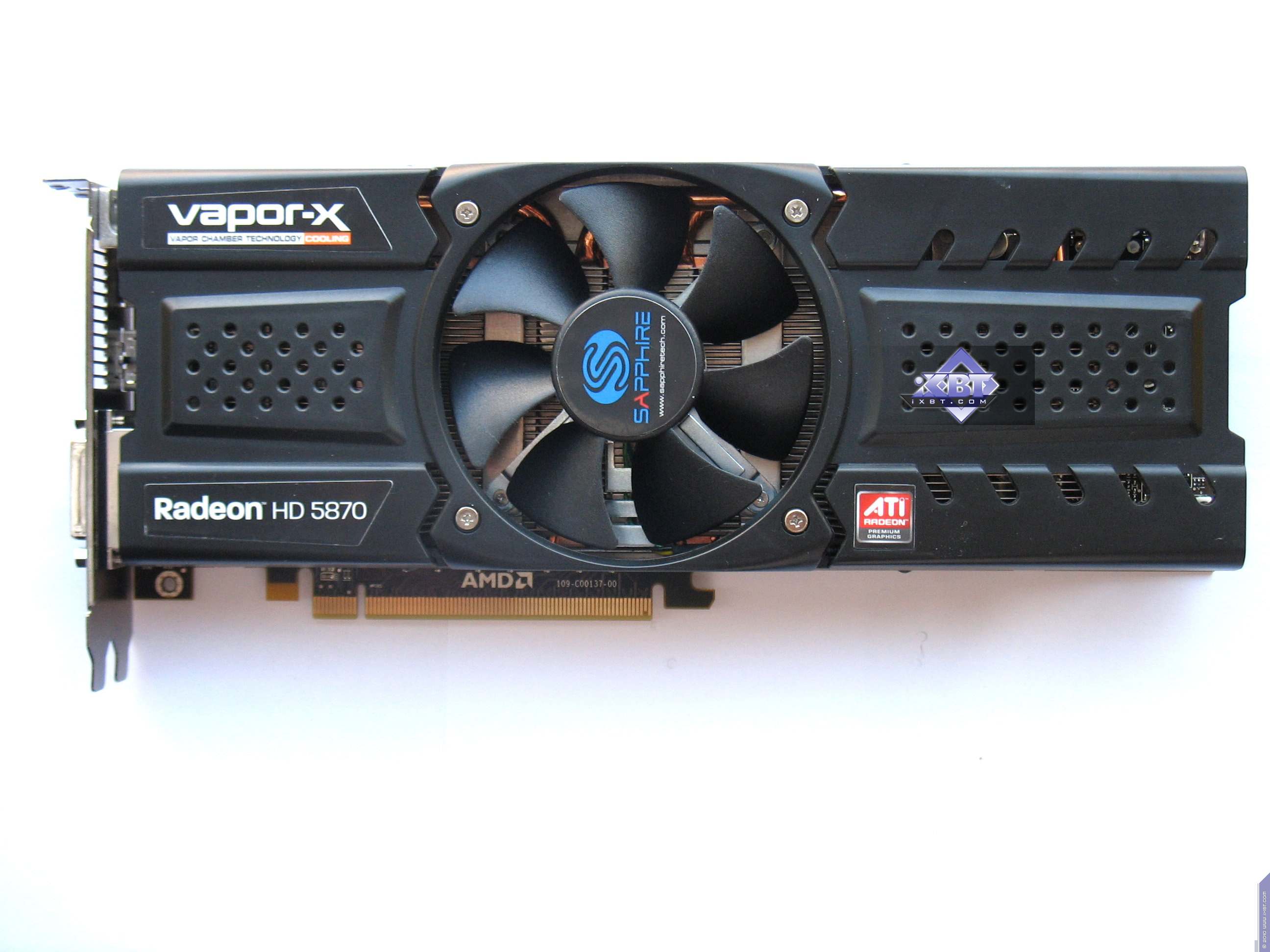

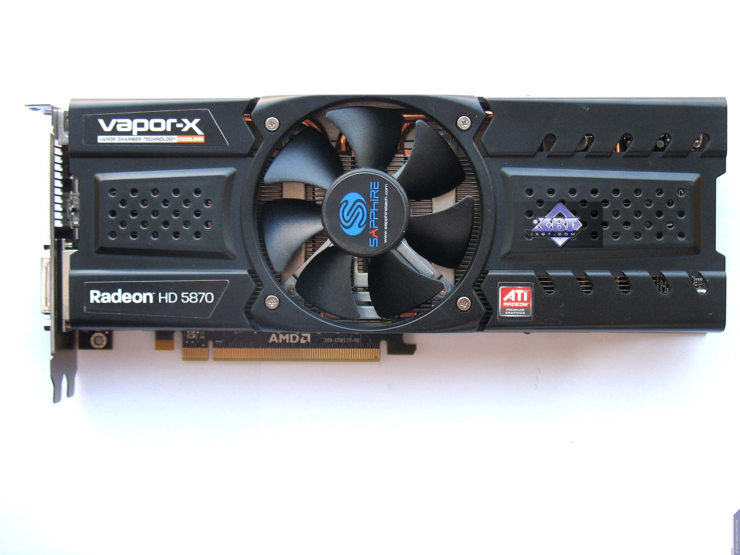

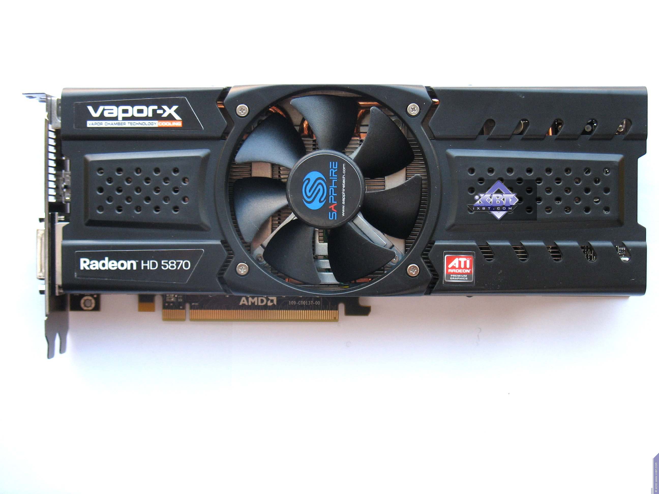

How often do you need a bootscreen? I have had no bootscreen PC cards (4870 & 5870 Sapphires) in my MP 3,1 since 2010 and have only swapped in my 8800GT mac card once in 4 years. You could keep the 2600XT in an upper slot and just swap your monitor to it when a bootscreen is required. Use the 650 the other 99% of the time.😀
No bootscreen but an awesome card in its day.

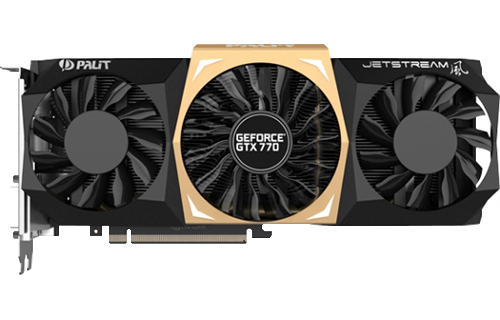

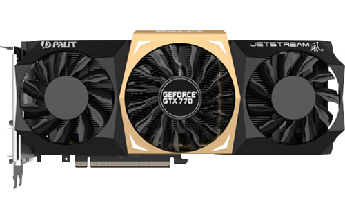

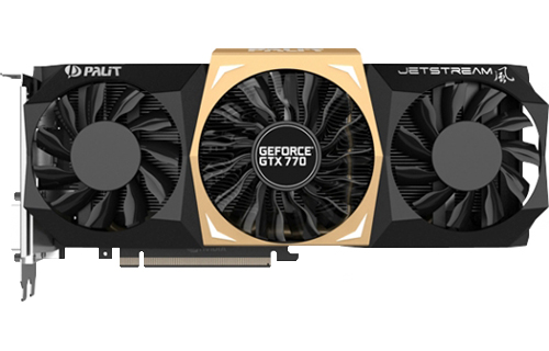

I put a Palit GTX770 in my Hackintosh, it flies:
