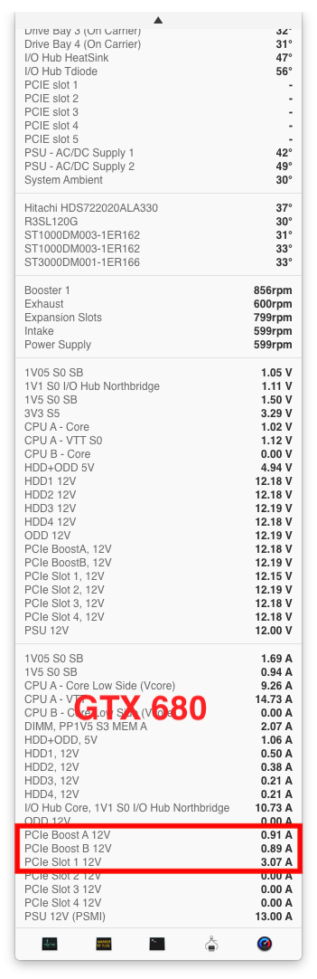

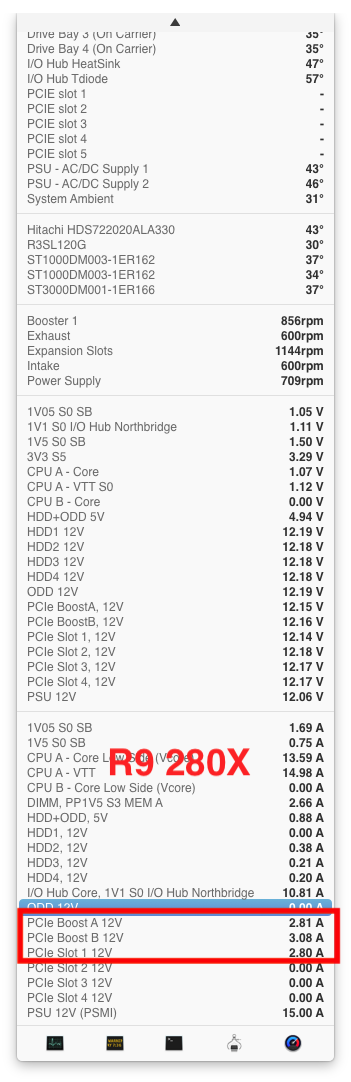

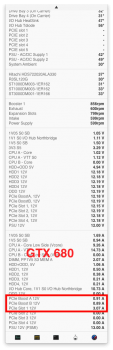

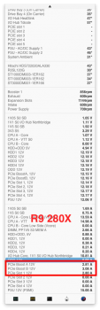

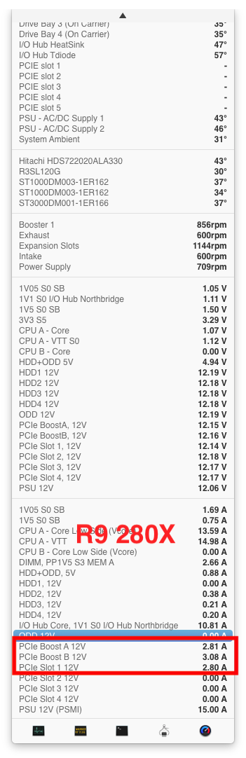

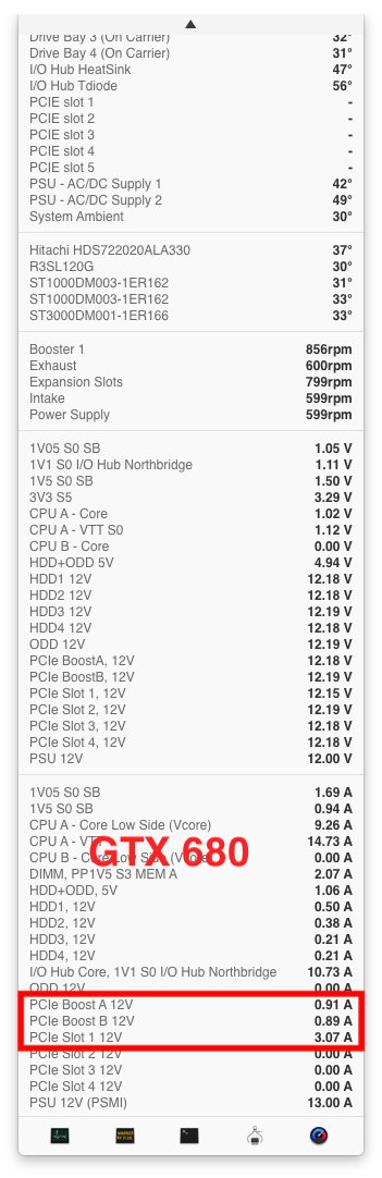

As I'm deciding at the moment (more like for a few weeks) which card to keep waiting for the RX580 or Vega 56, I was testing various things among GTX680 and R9 280X (two most supported and "newest", home flashable cards from both camps) and power consumption difference in multi monitor setup is a real shocker.🙄
These two screenshots were taken while both monitors (1080p Dell and 720p TV) were on and iTunes visualization was working, fullscreen, on 720p TV.
View attachment 720654 View attachment 720655

Yeah, for multi monitor setup, the card can't step down to the lowest power setting (low GPU and VRAM clock stage). That will make the card draw lots of power even at "Idle". For your info, 7950 (stock 800/1250Mhz) should idle at about 55W in multi monitor setup (roughly same as your 680)
Thanks for that, seems to be that 7950 is much better optimized and not much slower card than 7970 but 7970 has that D700 DevID advantage... Kind of...

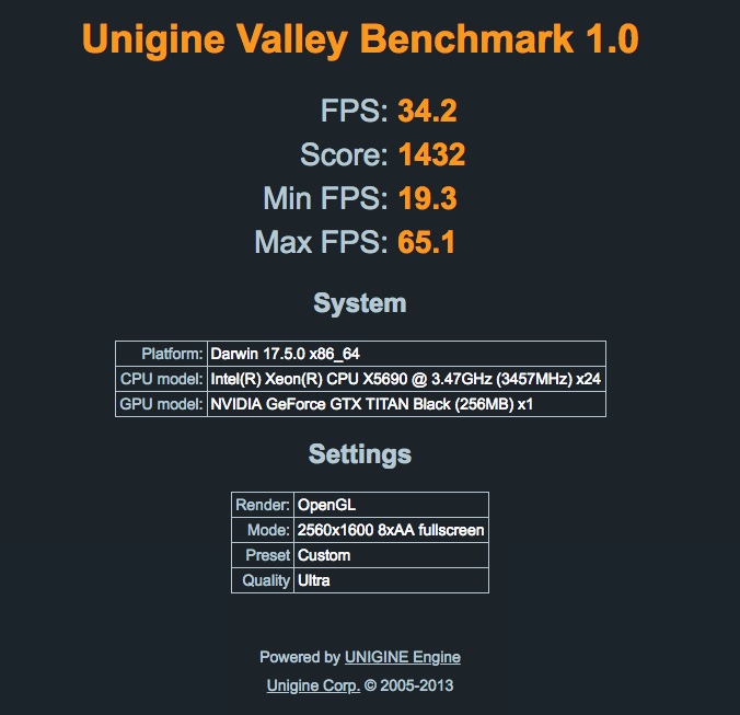

i have to warm up that thread...
yesterday, i installed my double hearted cpu daughterboard inside the MP and started to bench this and that.
when i tried the unigine heaven, the computer suddenly shut down after a minute...so i guess its too much for the 980w PS.
i just changed the cpu tray because i afaik, there are always the same PSs inside the mac pro 2009-2012, even it is an dual or single cpu type.
am i wrong ?
am i wrong ?

the titan black used to get about 370w when it is full loaded...maybe too much.
so better plug the gtx980 back inside ?
