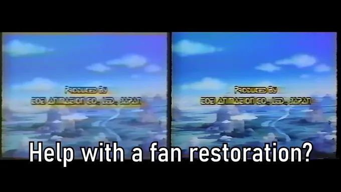

Does anyone know of a FCPX filter (or at this point - any other way) that lets you shift the VHS colour signal?
EG: You can see on the left hand image how the yellow is shifted down/right from where it should be on the titles; right side has it corrected:

G'day casperes1996,
The issue is with the entire colour layer having drifted away from the b&w layer.
(See image I've just added to my original post.)
The abovementioned filter allowed you to re-align the colour signal, so it would match up with the rest of the image.
Sometimes the drift isn't major, and you wouldn't think it would make much difference, but it really can improve the quality by fixing it up. And when the drift is bad - it makes a huge difference.
G'day casperes1996,
You can kind of see it in this:
(Not my material)
In the left picture, you can see the yellow that belongs to the titles has drifted down and slightly right of where it should be. (In fact - the entire colour layer has moved; it's just most obvious with the yellow).
Oooooh. I totally misunderstood, haha. I thought we were talking tinting, not chroma misalignment. I've never really had to deal with analogue editing 😛
