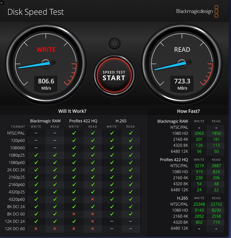

The write and read speeds for a 2TB T7 are below. This is quite fast enough for editing 4K video with Final Cut Pro, DaVinci Resolve or Premier Pro. Indeed, it's in line with what full-time professional film editors have from their NAS systems.

Whether it's fast or slow will depend on the type of work you're doing.
It still works fine for editing 4K videos, and is fast enough as shown in screenshot from F-train above.
