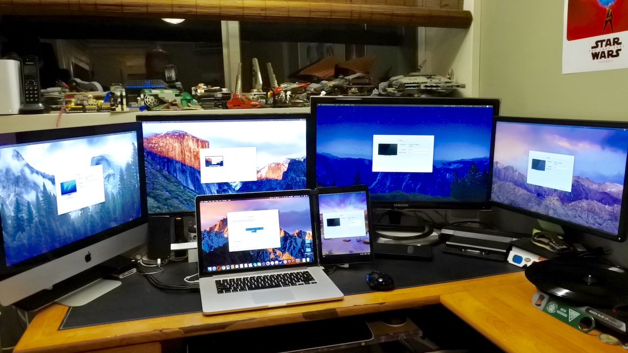

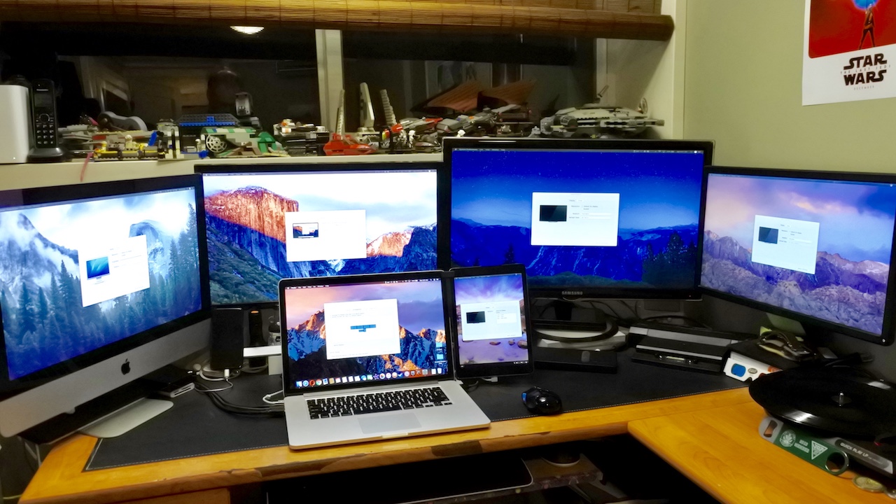

Note that no "Retina" iMac supports Target Display Mode. And even the latest ultra-low-end non-retina iMac with Thunderbolt 3 doesn't. Only 27" Mini DisplayPort and 21.5" and 27" Thunderbolt 1 & 2 non-retina iMacs support. (Officially, non-retina iMacs from 2009-2014.)
Here's my home setup, ridiculously using too may monitors at once, including using the iMac at far left as a display for my MacBook Pro. (Normally the MBP is in a dock behind, not using its own display, not using the iPad as a display, nor using the far right display which is for my work laptop.)
