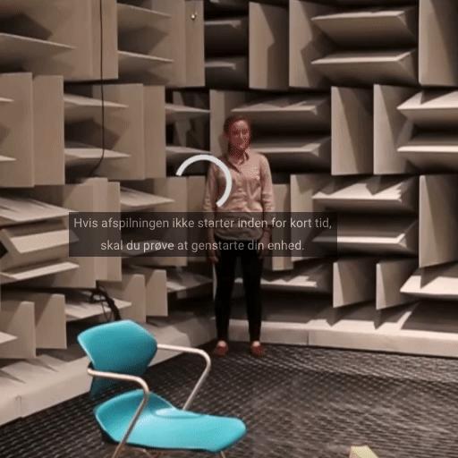

I have a MacPro 4.1 flashed to 5.1 running High Sierra. The firmware update and installation of HS went smooth. After this update however, my GTX 960 will stop video playback when using for instance youtube. The first frame of the video will load and it is possible to scroll through the timeline, but the video will not play. It just shows a wheel spinning, as when a youtube video is loading before playing (see attachment)
