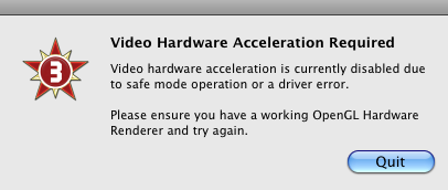

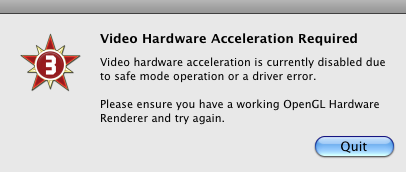

LOL,
first problem with the new Card!
Alright, now I have no idea. Did you follow the installation instructions correctly? I'm sure you did, but just making sure... To me, it would seem that the driver has not been installed, or there needs to be some update.
Anybody else want to chime in on this?
Actung! That complicates things... Well, I personally would try and route power from the molex connectors to the 8800GT. If you don't feel like doing that, you should try and get a MiniDisplayPort to DVI connector - You would need the single-link for lower resolutions, and dual link for higher (Above 1920x1200, if wikipedia serves correctly). Still, running the higher-resolution monitor on the 4870 is a must to get the most out of it.
Avoid the mini displayport to dual link adapter, it's crap.
I received an error message very similar to the one you've encountered, although it was not caused by the ATI Radeon 4870. I have an '09 MP with ATI 4870 and a Blackmagic Decklink video I/O card.
It was the Decklink causing the 'openGL' error message when I would attempt to open Color. A setting in the Blackmagic preferences, extended desktop, was causing this error. The remedy was to disable 'extended desktop'.
Don't know if that helps but what the hay. Maybe it's a display preference setting? Maybe try poking around system preferences->displays?
