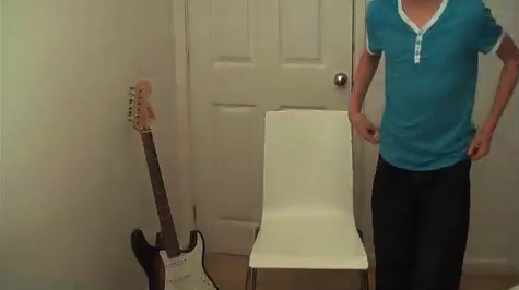

When i import from my camera into fcp the video quality looks fine and it is hd and when i play it frame by frame the video quality looks fine, it's just when i play it, the video suddenly drops in quality and goes slightly pixelated.

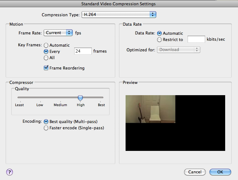

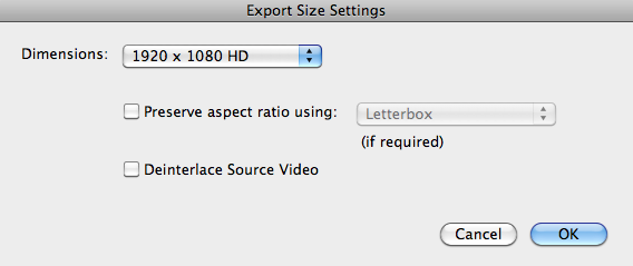

I just exported it and the it is still pixelated,
My camera shoots 1080p and i set the export setting all correctly,
so what's the problem now ? Because it can definitely be higher quality as if you go frame by frame in the fcp file it is the quality it is supposed to be

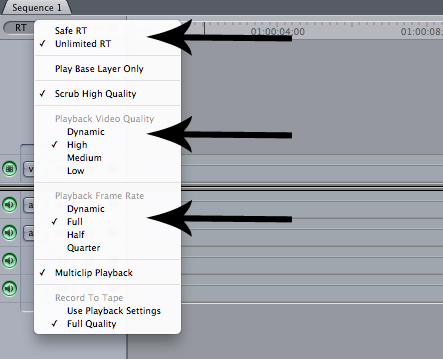

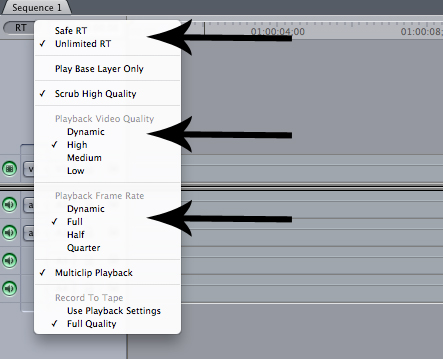

Do you have any filters applied? Adding a CC filter will often turn your render bar green and to render that you need to use option+R
If you have no filters applied, check you RT playback settings. Your machine may not be fast enough for your source video or mayeb your settings are set too low. Personally when I am doing long form editing I wold rather see (on a slow machine) a dropped frame here and there rather than reduced playback all the time, but that is just me.

File > export > quicktime movie is exporting it full res. You are transcoding to h264 doing it the way you are.

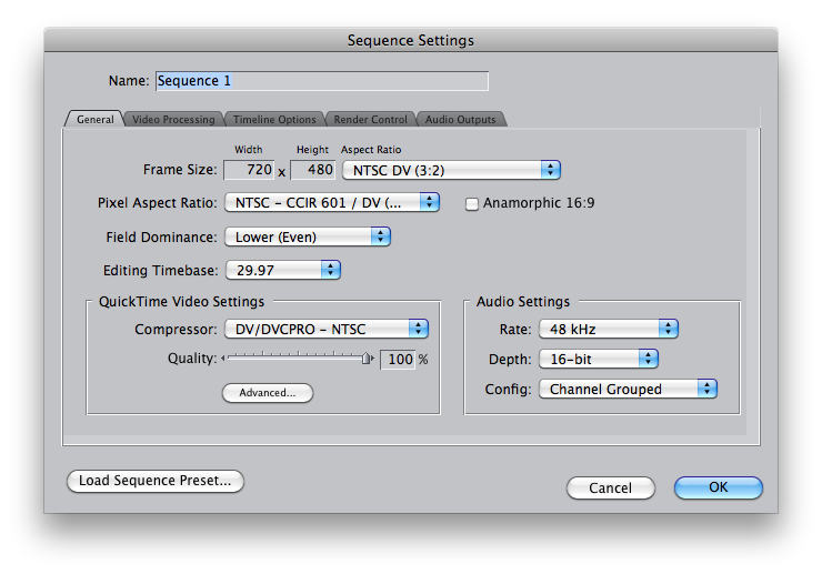

But what is important is your sequence settings. Apple+0.
The we need to know what your clip setting is and you can find that in the browser or by opening in quicktime and hitting Apple+J
Be in your timeline and hit Apple + 0 (that's a zero) and take a screencap of that window, it will look like this:
attachment.php
The take a screenshot of your clips settings in your browser window so we can see if your clip and timeline settings match:
attachment.php

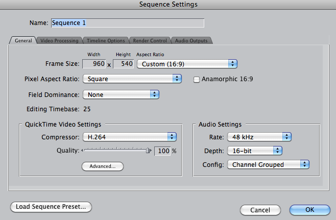

You need to make your timeline be the same as your clip. it's that simple. And this is usually done automatically when you apply your first clip.
What are your clip settings?
The sequence settings are not 1920 x 1080 though, and H264 is not a proper editing codec, ProRes (FCP) or Apple Intermediate Codec (FCE) is.

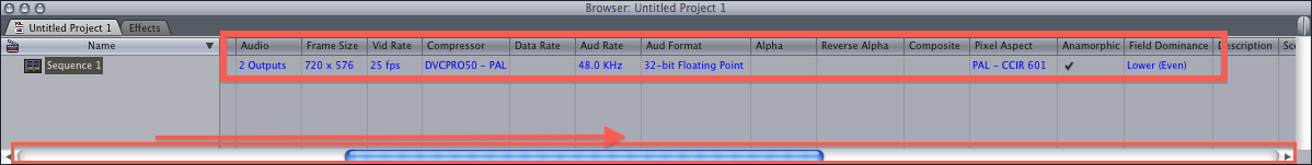

Open the source clip in QuickTime Player and press CMD+I.
Or scroll to the right in the FCP browser to see more details about your clip.

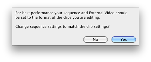

Your clip is fine and your sequence is the problem. So like I suggest in post #8 create a new sequence. Drop your clip onto it and you should see this pop up:
attachment.php
Press yes and your problems are solved.

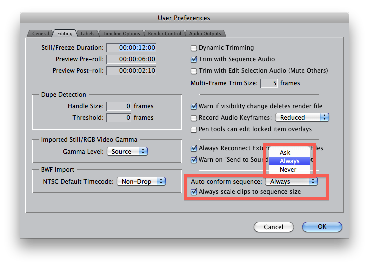

Make a new Sequence, make sure the ALWAYS ASK option is selected in USER PREFERENCES > EDITING,
then drag the source clip onto your timeline. Or change the sequence settings of your current sequence to match the source clip.
