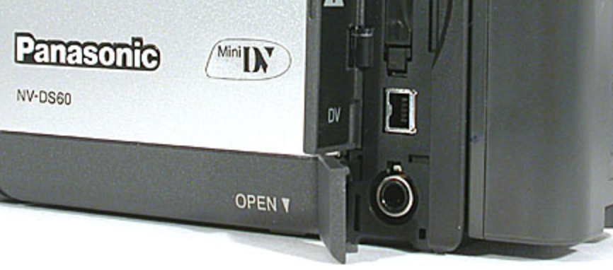

Looks like there is a FW (DV) port on the side of the Panasonic NV-DS60. I was surprised when you mentioned a DVT camera that lacks digital video out (like FW). The older analog tape cameras wouldn't have a digital interface.
There are inexpensive composite video to USB converters that could be used by either computer. But thats a pain to set up, and video quality suffers.
Apple has an inexpensive FW to TB converter that works very well.
I would think about saving the captured video file on a portable USB drive or stick and that video file becomes portable. Getting it into a PC (or any other computer) would be a simple file transfer. I'm sure you would find a PC program for capturing digital video, but PCs with FW ports are not as common.
