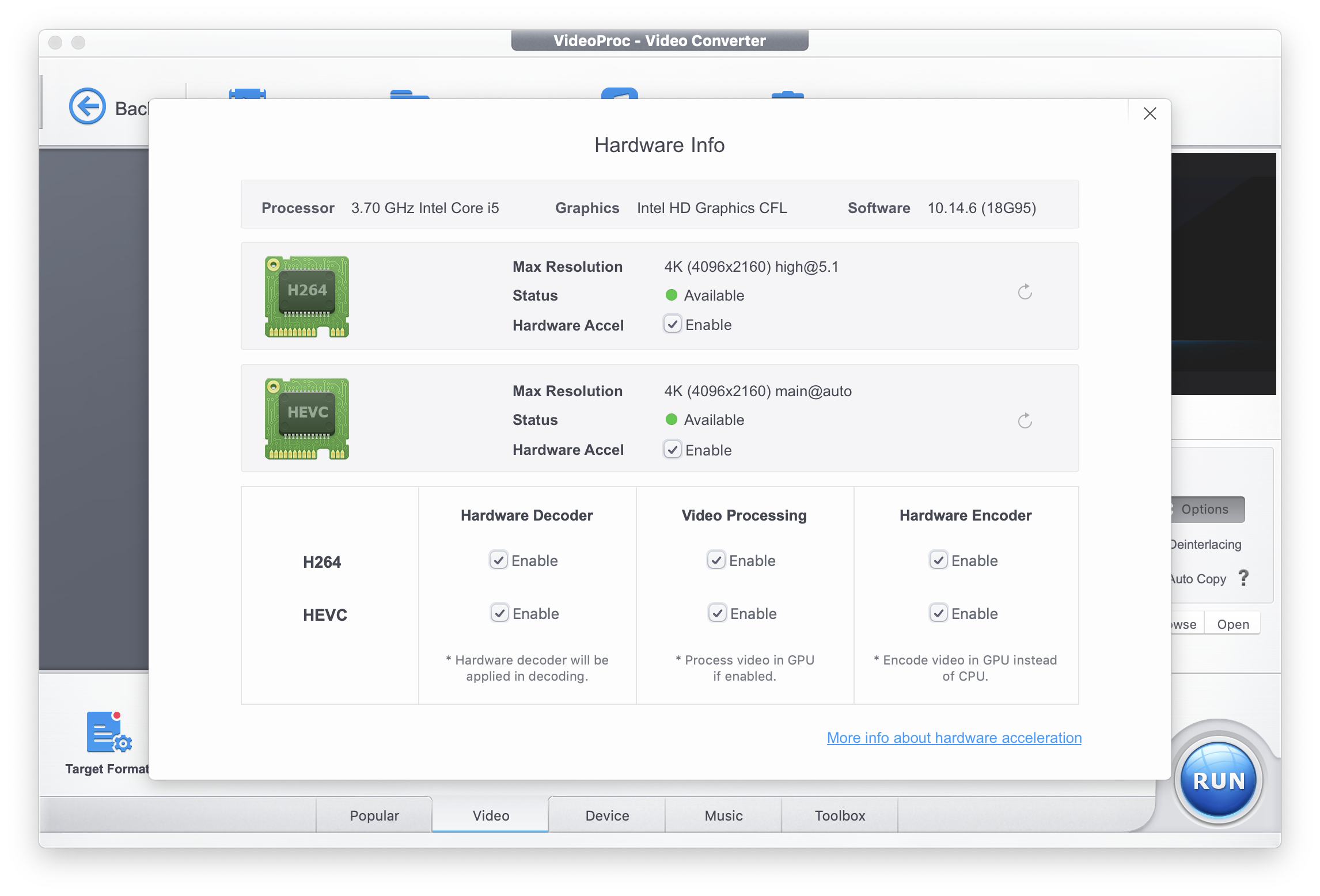

I have an iMac Core i5 3.7 GHz with a Vega 48 and I tried lately VideoProc on it. The company developing it says that it supports almost all the newer GPUs for hardware acceleration. However, in this particular iMac model it detects only the Intel HD graphics, completely ignoring the Vega 48.
Could you (iMac and iMac Pro users) please install this multi-purpose video converter and check what does it report in the hardware acceleration settings? Does it see and report correctly your GPU? The trial version has some limitations but it will let you check the settings and even do conversions of short videos.

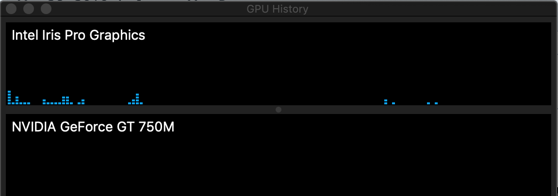

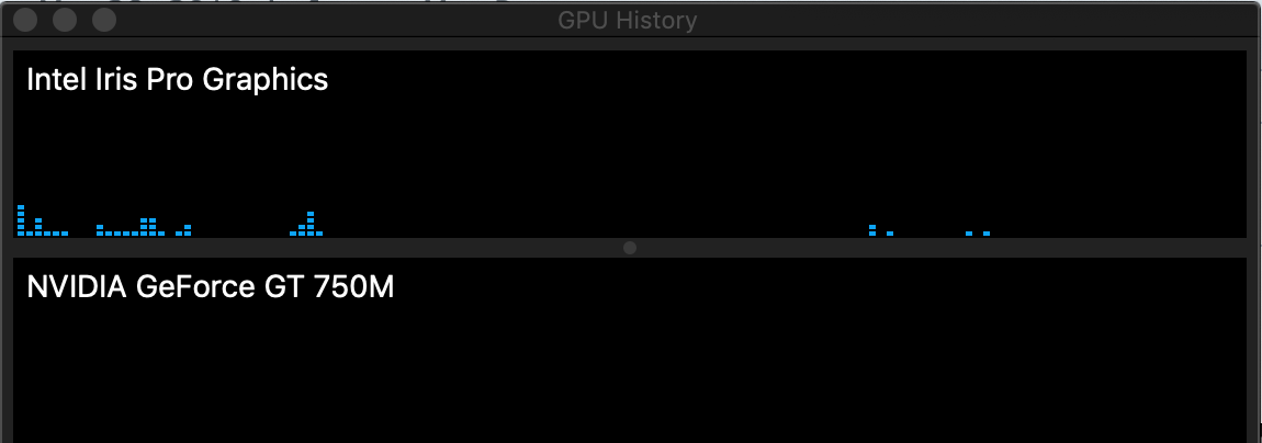

Have you tried doing something video-ey while using Apps-Utilities-Activity Monitor? GPU History (essentially a rolling bar graph of GPU activity ) is Cmd+4. You should see two graphs: Intel Pro Graphics and Vega 48.
Activity Monitor shows only the Vega 48. iStat Menus show both Intel graphics and Vega 48, if this is what you mean.
I have tried video players and I have already seen (through iStat Menus) both Intel and AMD graphics been used in video decoding through these players. However, VideoProc relies exclusively on the Intel graphics. I have done some conversions with it and I saw it using only the Intel HD graphics, in accordance to what it reports in the settings.
Therefore, despite the assertion that it supports everything from AMD Radeon HD 7700 series and up, it completely ignores the Vega 48. I am very curious to see what it does detect on iMac Pro that does not have Intel graphics. Or in any iMac for that matter.

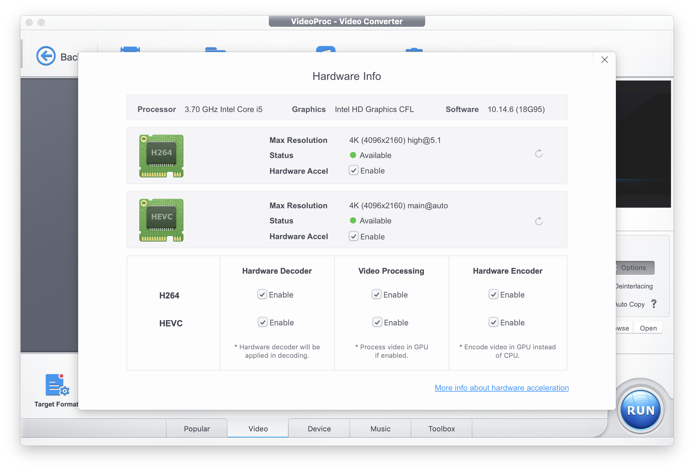

But it does not really matter. Decoding or encoding, VideoProc ignores completely the Vega 48 while it should report it in the settings according to the company's notes (as it does for Intel graphics). I guess you have not tried to install it yet. You can see in this figure what the options look like:VideoProc.png

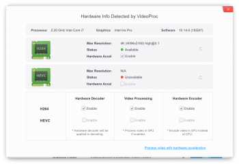

I have, see my post #7 above.

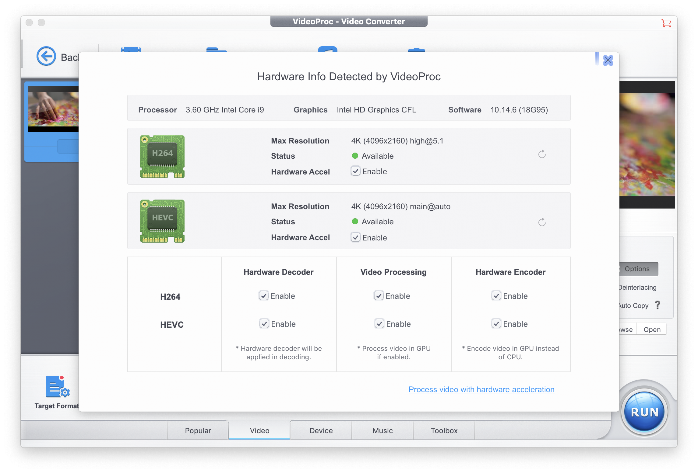

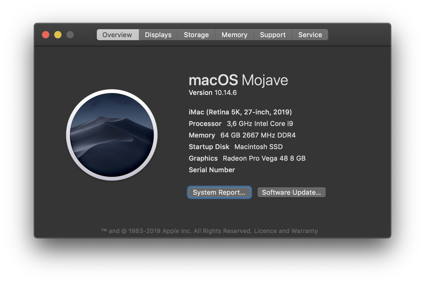

Sorry, I somehow missed the screenshots. So, it is the same on the i9 iMac too. I am genuinely curious to see what it gives on the iMac Pro with the Vega 56/64/64X but without QuickSync.

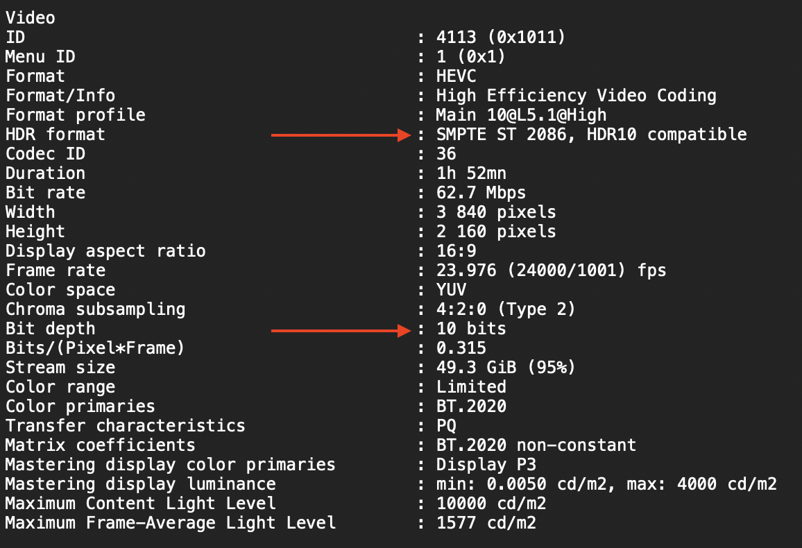

I am not sure that VideoProc can process 10-bit HEVC. Unless 10-bit is well understood in HEVC?
10-bit is very well understood in HEVC, because it is a must for HDR10 and HLG encodes.

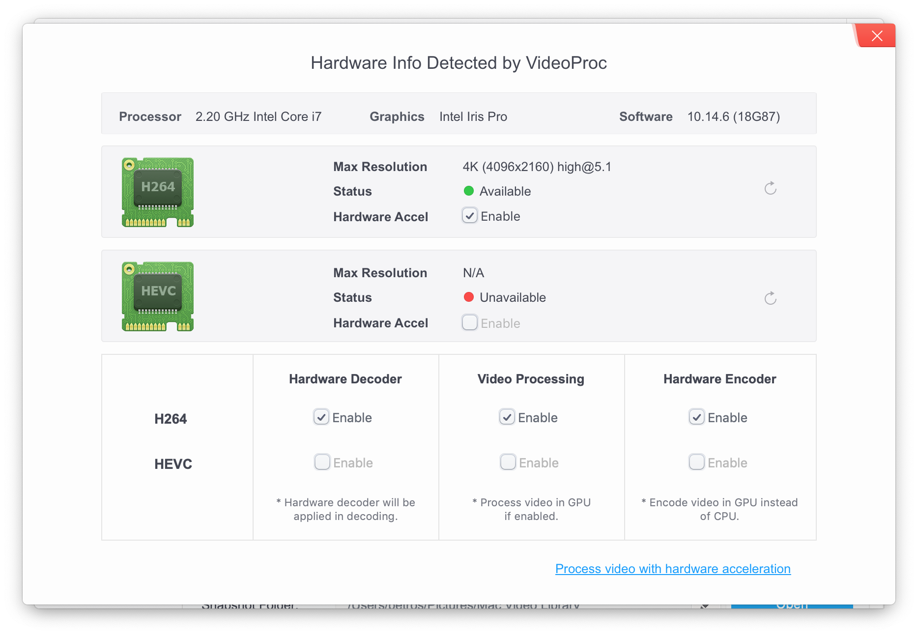

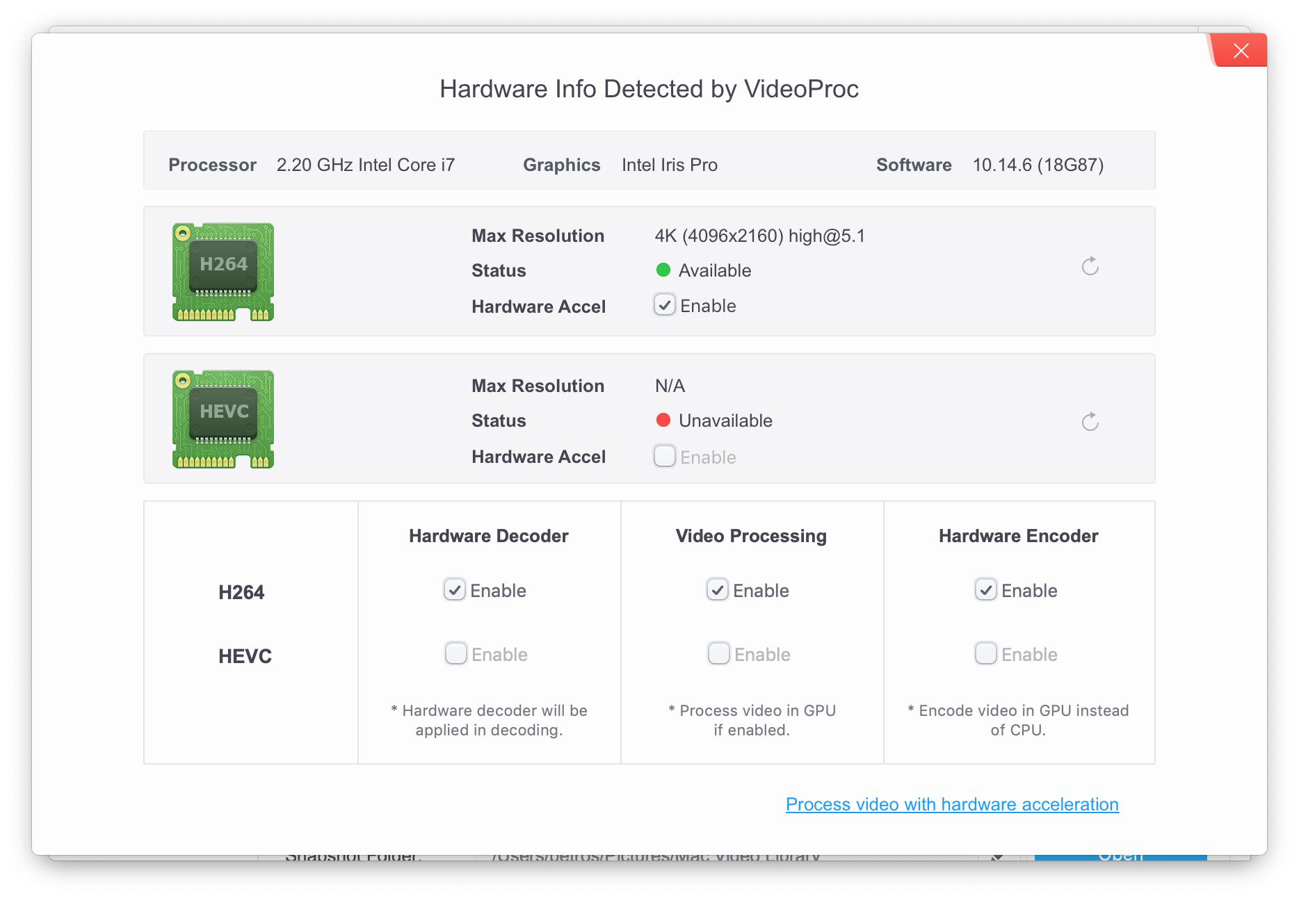

I installed in the meantime VideoProc on a MBP i7 from 2014. The options screen now is this:
This machine is equipped with Intel graphics only, so no surprise here. It is normal I suppose to not have HEVC in this case.
