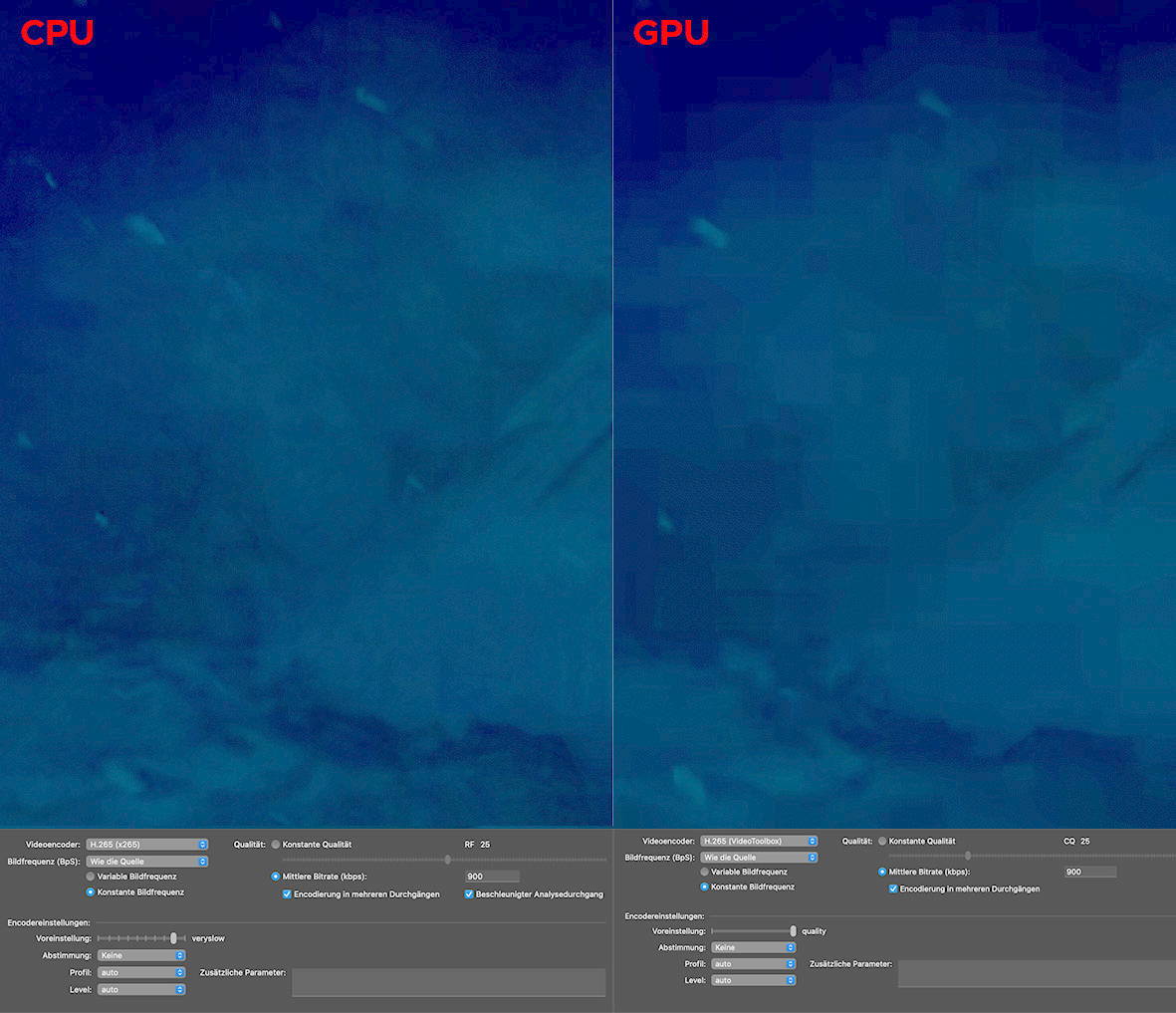

CPU encoding gives a better quality at the same size.
This is H265, but H264 is nearly the same. I light up the Picture with gamma correction to better show the blocks.

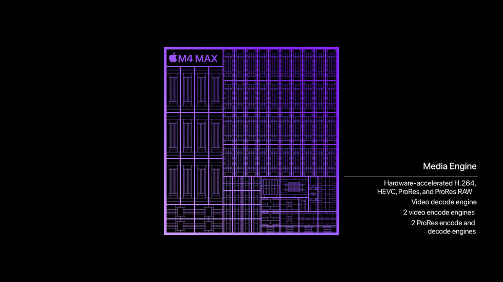

VideoToolbox does NOT use the GPU on Apple silicon. It uses the Media Engine, dedicated cores created specifically for decoding/encoding.

Also note AMD, Nvidia, and Intel also all have dedicated engines for decoding/encoding -- Nvidia and AMD's cores are of course on their GPU cards but they aren't using the GPU functions to do the encoding as that approach has not proven itself as effective as media-specific hardware.

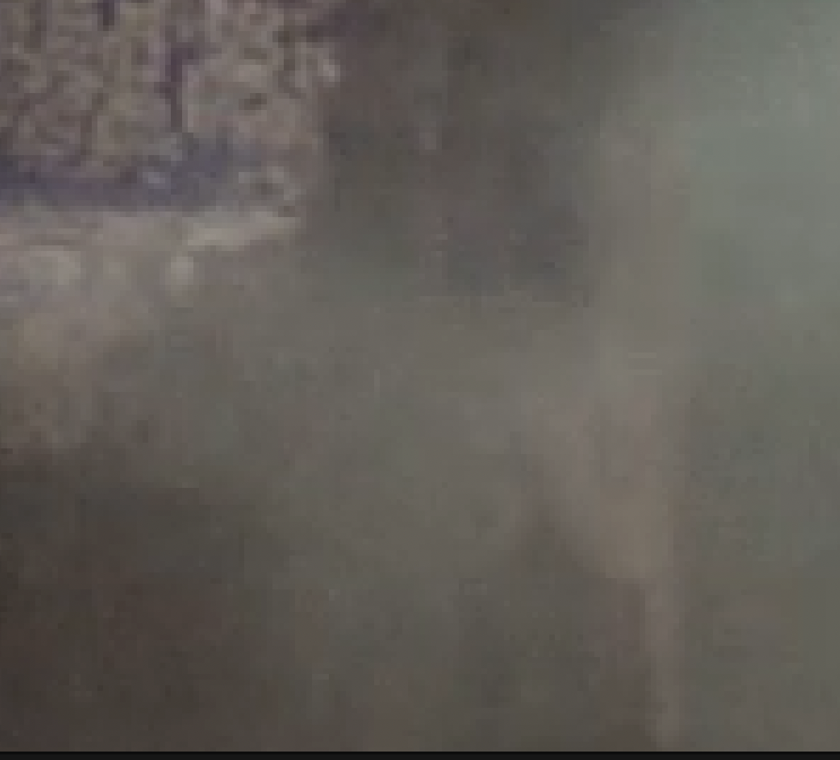

Over the time of 14 years, I've encoded around 5000 videos. And during that time, I've learned that no AMD, NVIDIA, or M-Mac hardware encoder has the same output quality as the CPU encoder and get the same size.
You can have acceptable quality but with bigger size.
For example:
I have encoded a Clip in H264 on CPU in a very good quality and get a size of 5 MB. With Videotoolbox (M1 Ultra) I didn't even get the same quality when the file was over 20 MB. with Videotoolbox.
So I can choose whether to use CPU H264 or Videotoolbox H264/H265 and maybe get a file that is approximately the same size, but still not the same quality as the CPU encoded H264.

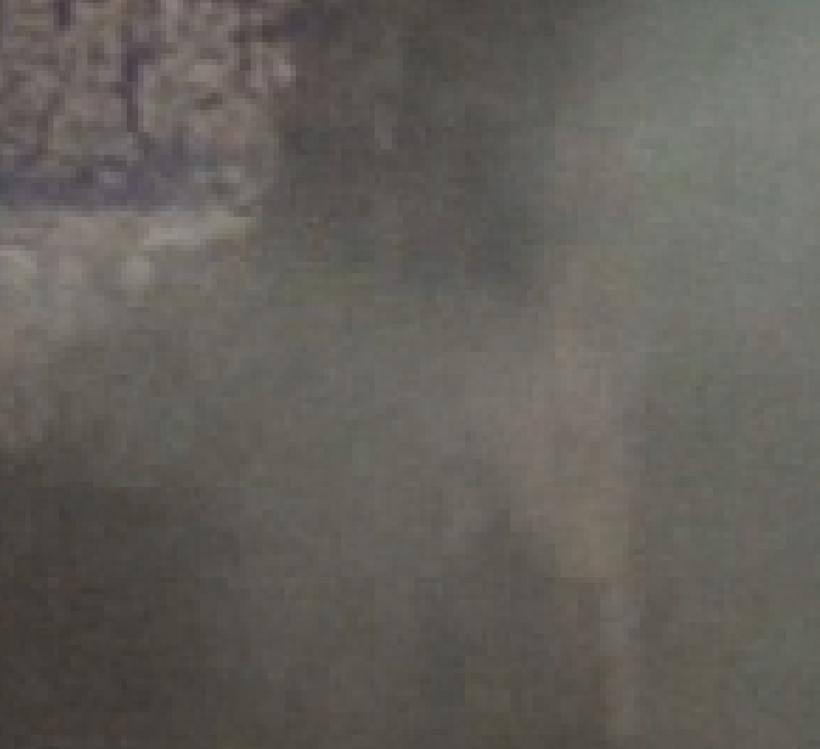

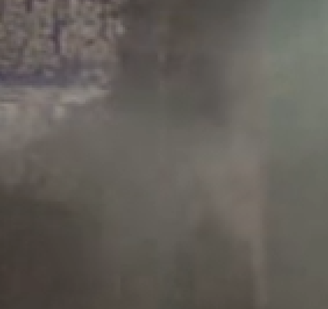

Here:
Original Source, 1080p, 800% zoom

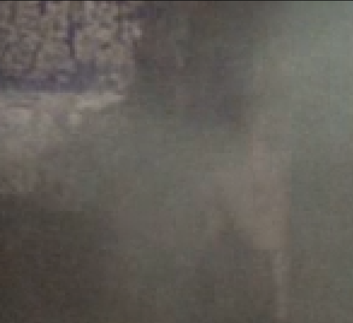

H264 CPU, M1 Ultra, 10000 kbps, very slow (6,2 MB)
level=4.1:ref=4:b-adapt=2:direct=auto:analyse=all:me=umh:subq=9:trellis=2:vbv-bufsize=78125:vbv-maxrate=62500:rc-lookahead=60:aq-strength=1.4:bframes=4:deblock=-2,-2:weightp=0

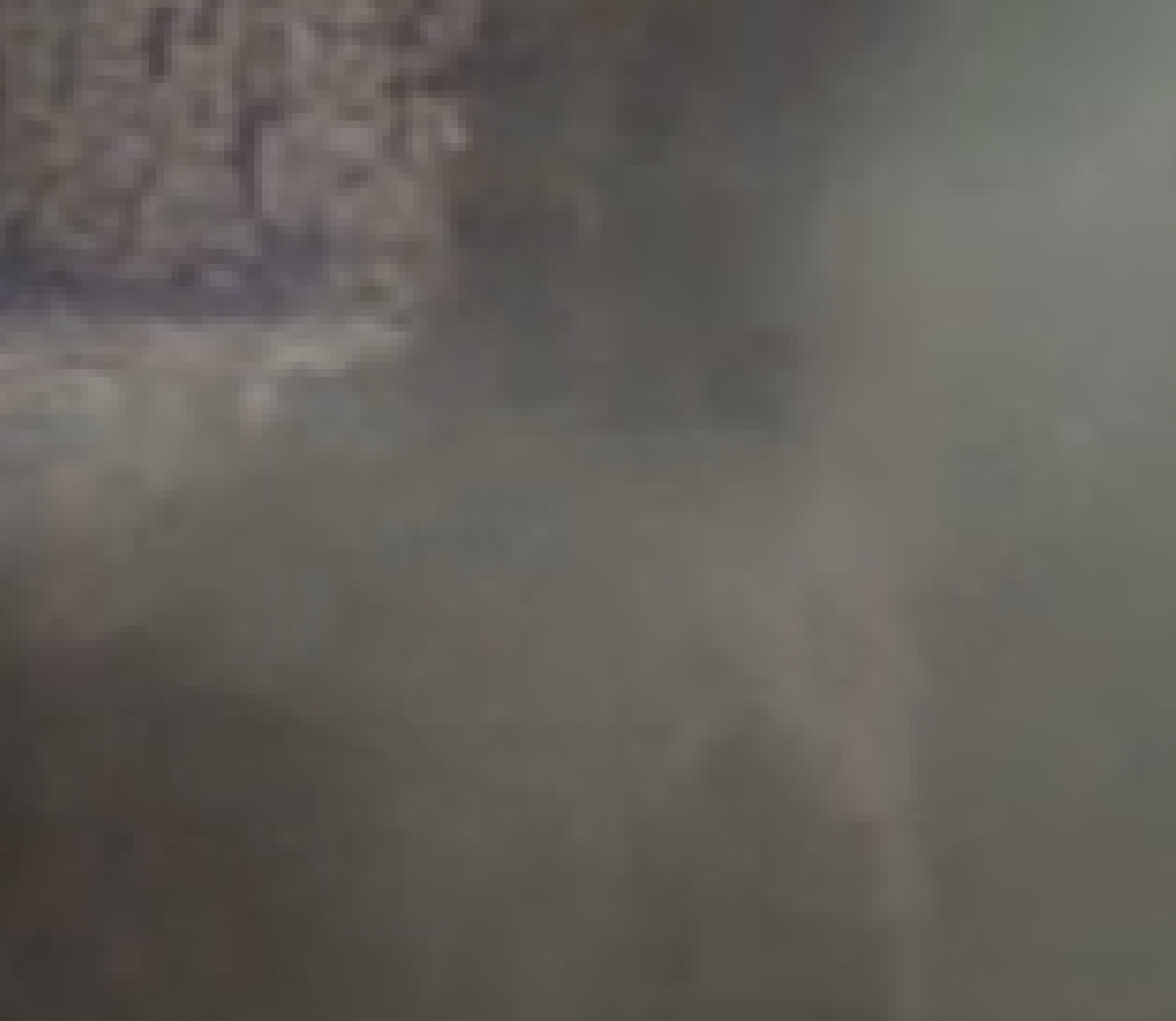

H264 Videotoolbox, M1 Ultra, 10000 kbps, quality (6,7 MB)
H264 Videotoolbox, M1 Ultra, 20000 kbps, quality (13,3 MB)

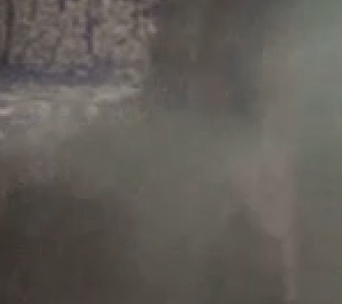

H265 Videotoolbox, M1 Ultra, 10000 kbps, quality (6,8 MB)

Original again
ffmpeg -i Star.Wars.IV -c:v h264_videotoolbox -profile:v high -movflags "+faststart" -b:v 10000k -c:a aac -b:a 160k "video_10MB.mp4" (size 6,6 MB)
