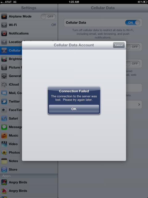

I tried both AT&T and it told me I was out of data which I wasn't so I removed it and installed AT&T (HSPA+) which lets me connect again but I am still unable to use View Account.
Now I get

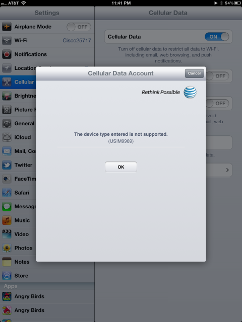

What SIM are you using? When I put my 4S SIM, it always gives me that error, but I can still browse. However, I do have a blank AT&T SIM that's 4G LTE that's unactivated that doesn't work at of course. I had hoped it would, even with the APN change. Oh well.

If that's the case, it's probably because you don't have an iPad account. Or more probable is that AT&T is not recognizing your IMEI number that is being sent to them. They have a list of theirs and VZW has a list of theirs.

You won't be able to use the Verizon iPad to manage your prepaid AT&T iPad data plan, because AT&T doesn't recognize the IMEI number of the Verizon iPad.
There is a workaround, but you have to manage your plan from the website, and you'll need the IMEI number of any iPad that is officially supported by AT&T. It can be the original iPad, iPad 2, AT&T version of the new iPad, or any GSM iPad that was sold outside of the US.
Go to http://www.att.com/ipadlanding, click Get Your Pass, enter the IMEI number for a supported iPad and the ICCID number from your SIM card, and sign up for service.
There's no way to get the View Account function for AT&T to show up on a Verizon iPad.

ATT account can't be viewed on a VZW iPad but as you see it does work. You can access your ATT IPAD WEB account from the iPad and view it there. www.att.com/ipad and choose "shop now" in the "add more prepaid data" on the right side of the page. You can create or manage an account or add funds there.
Alright. I will just manage from the website like I have been doing. I may try Verizon when my data runs out but from recent testing with air cards lately it seems AT&T has over took them around here.
