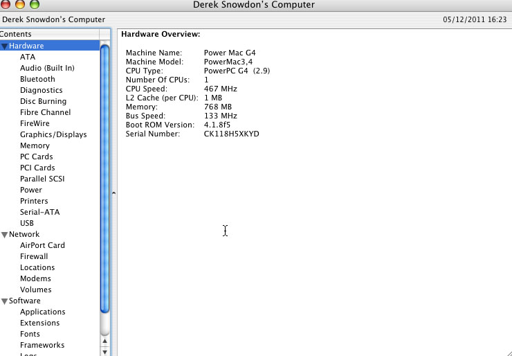

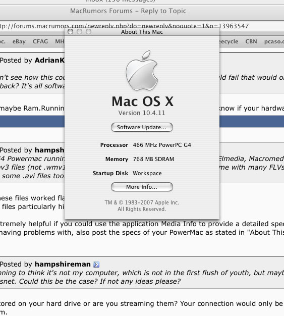

Sorry - forgot these two images

Judging by the fact that you're running at 466MHz, I'd say that your problems are caused by a lack of processing 'horsepower'. Video decoding is a demanding task, specifically for high resolution content, which is processed solely on the CPU.
