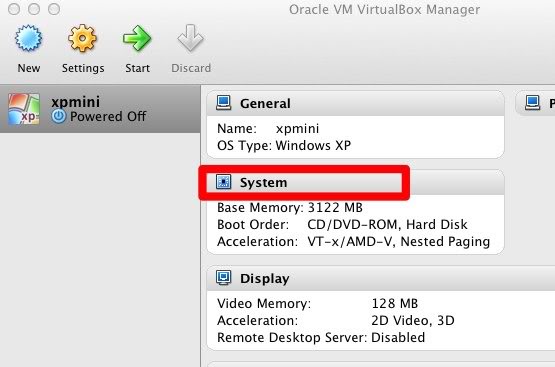

to increase the RAM allocation for a virtual machine in virtual box:
run virtual box
select the virtual machine in the list and make sure its listed as powered off (dont actually start the VM while trying to make changes) in this example its XPMini
double click the machines system details entry
in the dialog that appears use the slider to increase the amount of allocated ram
hit OK to save your change and you're done

Once its completely shutdown its entry in that first dialog should read as 'Powered Off' and you should then double click that system setting and slide the Ram allocated slider to 1gig (maybe even 1.25 or 1.5 gig on a 4 gig of RAM equipped mac)

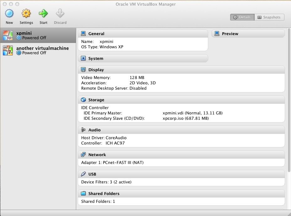

when i fire up virtual box from icon on dock or from applications folder I get the Oracle VM Virtual Box manager window
from there I can pick any of my virtual machines from list on the left by highlighting one an hitting the start button just above them, or make changes to one of them while the actual virtual machine (eg XPmini) is powered off..

the icon i use to launch Virtual Box that way is this one from my dock (its also in my applications folder)
