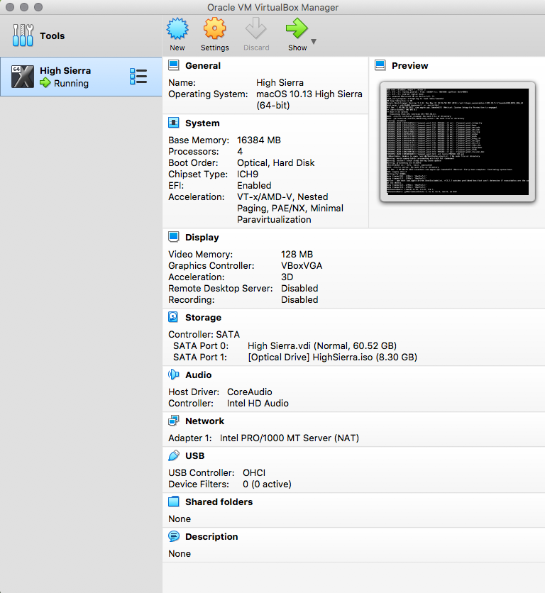

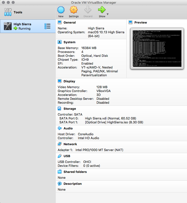

Can anyone with some experience with VirtualBox, or virtualising in general see anything wrong with this config, that would be causing it to be glacially slow or panic on boot?

You have four cores allocated to the VM. Try changing that to one. Virtualbox has never worked very well with multiple cores, at least on the Mac side.
Reactions: mattspace

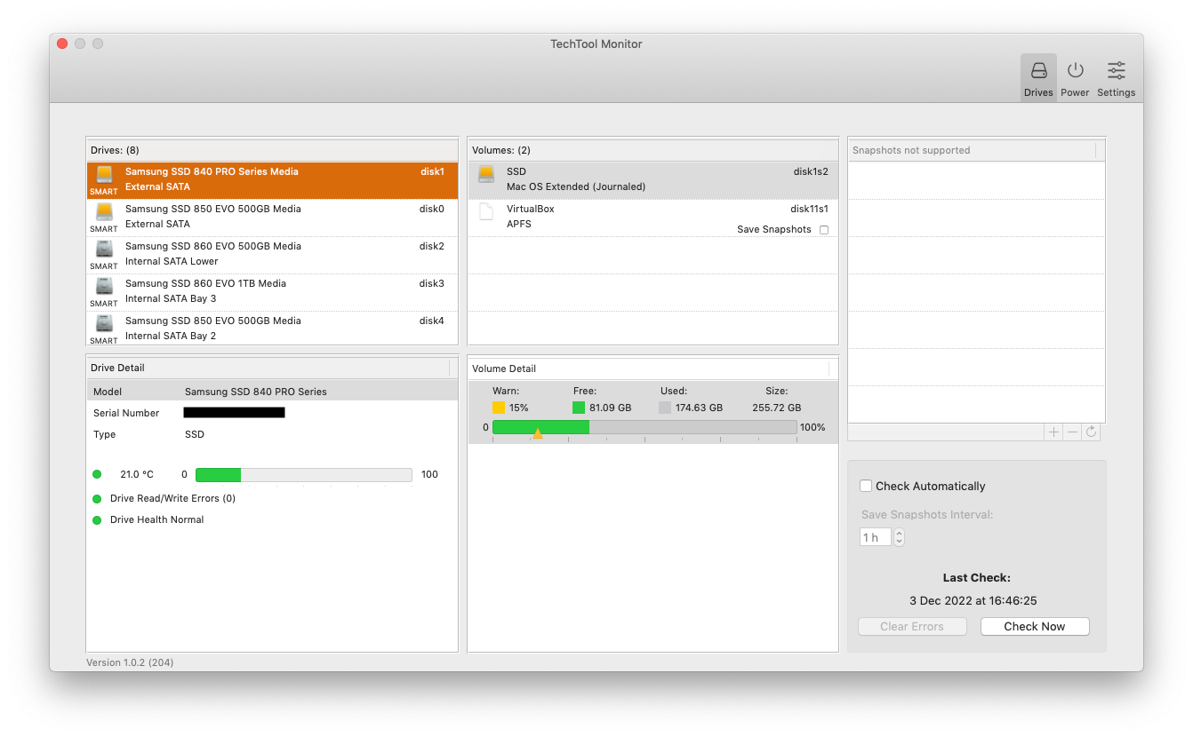

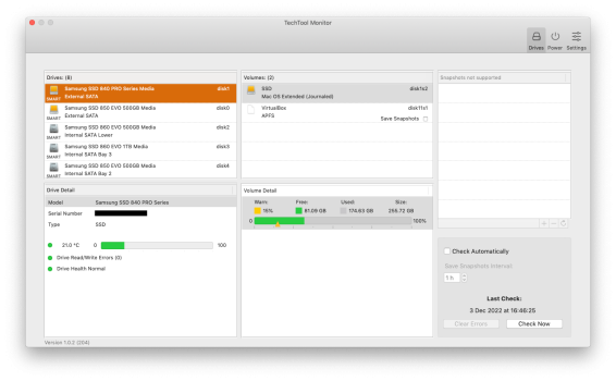

Since I un-installed VB, I noticed this in TechTool Monitor....
Nothing shows in Finder/Disk Utility/System Profiler for this drive, only in TechTool.
It's probably not worth bothering about, just wondered if there is a way to remove it, maybe in Terminal?
