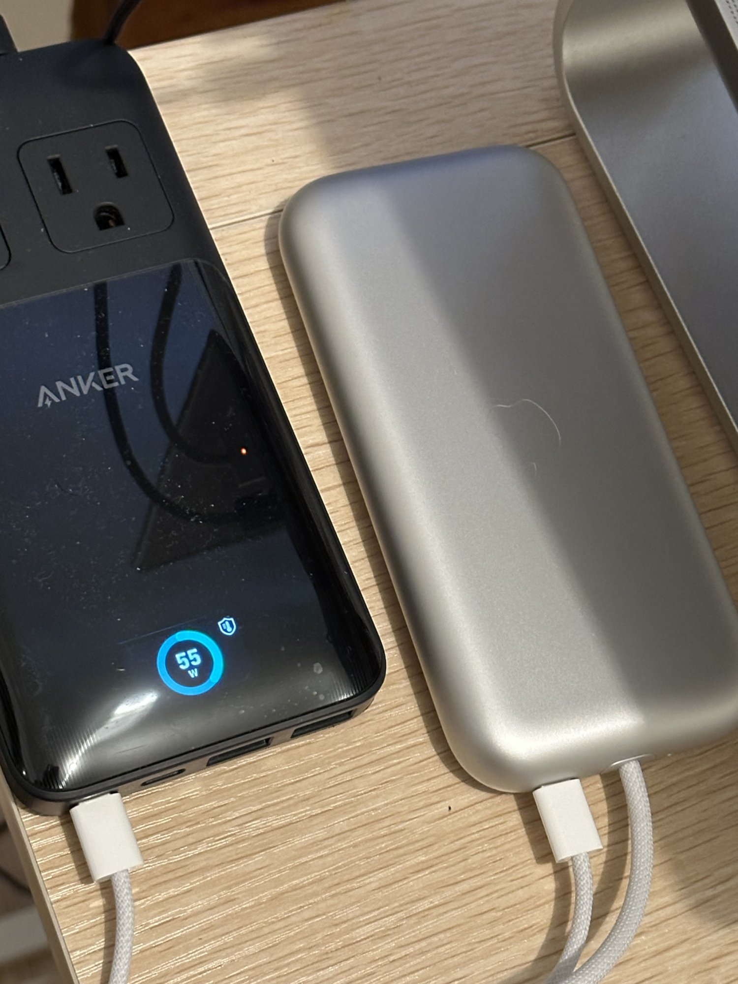

Heat will greatly slow down charging. I had the pack in my pocket and it wasnt charging faster then hhe drain. Cooled off the pack issue solved.
The Vision Pro battery can draw 55+ watts so I normally don’t use the supplied charger.

I used my humongous Macbook Pro charger on it and recharged in super fast time.
30W charger is great for travel (small & light), compared to hauling around a 140W MBP charger.....
The battery alone can draw 60W+ although it usually draws less.
