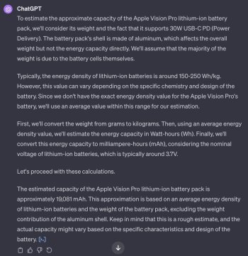

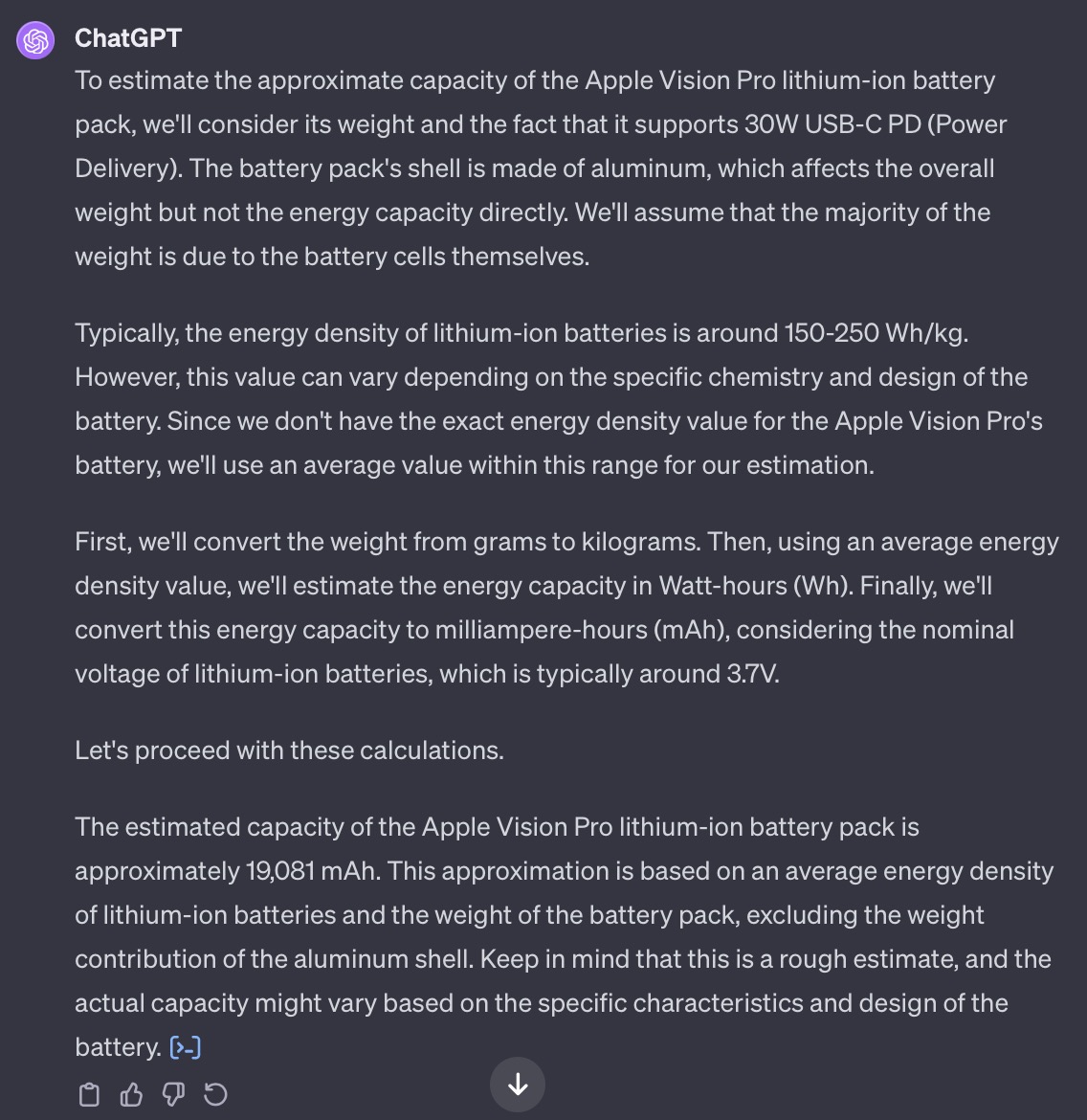

I did a bit of figuring now that we know the official battery pack weighs 353g. GPT-4, armed with the knowledge that it's a lithium ion battery that supplies 30w USB C PD, weighs 353g and has an aluminum shell estimated approximately 19,000mah. I'm betting with the exact power density number and actual weight of the shell this is for all intents and purposes a 20,000 mah pack.
This also means the Vision Pro likely consumes ~10,000mAh per hour, give or take. So a 20,000mah 30w USB C power bank is likely to add an additional 2 hours of runtime when plugged into the AVP's battery pack. I believe this is going to be the preferred way of extending battery time on the Vision Pro rather than buying extra $200 packs from Apple and having to shut the whole device down to swap.
There are tons of 20,000mah 30W PD power banks all over Amazon and most are under $50. I think the goal now is to find the one that's closest to ~350g that offers the best bang for the buck and stock up.
Just wanted to share this as we're all figuring out what accessories to buy and how to keep it running in scenarios where you won't be sitting at a desk or on the couch plugged into wall power.
According to this analysis[1], the battery is estimated to be in the 30,000-50,000mAh range.
Pretty sure the battery he's using as the "known" is a 10,000mAh USB-C PD power bank that I own for my Quest 3, which puts his estimate for approximately double that (~20,000mAh) right in line with the above number I arrived at.
Here's the battery: https://www.amazon.com/gp/product/B07XW7ZVKD/ref=ppx_yo_dt_b_asin_title_o06_s00?ie=UTF8&th=1 note it only does 20W PD. I'm not sure where he's getting 37.5wh and he didn't have the weight way back in the summer when this was written.
I think it's an approx 20,000mah PD pack. Maybe 25,000 at the top end but at 353g inclusive of the aluminum casing I don't think it's possible in terms of energy density to fit more than that in.
Don't think it can exceed 27027mAh and be able to be legally carried onto a plane. Since Apple's own promotional videos show it for this use, I speculate part of why it is so physically small is to be UNDER the MAX battery for that purpose. In other words, whatever it is, I suspect it will not exceed 27027mAh.
