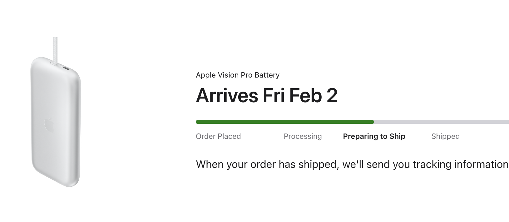

Extra battery finally went from processing to preparing to ship!
11 days and my AVP also shipped out of China this morning.

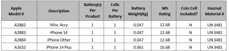

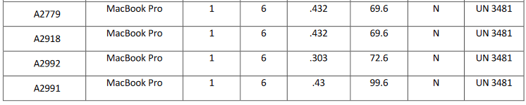

mAh tells us nothing without knowing the voltage. Nobody uses mAh except for marketing purposes.
To know the energy capacity, Whr is the only relevant measurement. That's why Apple reports Whr in safety reports and most credible battery bank manufacturers also use Whr.

Uh, that Macbook battery has a capacity of 8700mAh * 11.4V ==> 99.18Wh. That "20,000mAh" USB battery will likely use a voltage of 3.6V-3.7V (Anker batteries seem to use 3.6V), and so its capacity will be around 72Wh. Even ignoring electrical efficiency losses (as you say, these do exist), a 72Wh battery shouldn't give you even 75% of a charge for that Macbook.
Battery capacity in Wh (Watt-hours) is the real comparison metric, but this is typically written in very fine and hard-to-read print on both Macbook and USB batteries. And Amazon listings rarely list Wh numbers, only potentially-misleading and confusing mAh ones.
