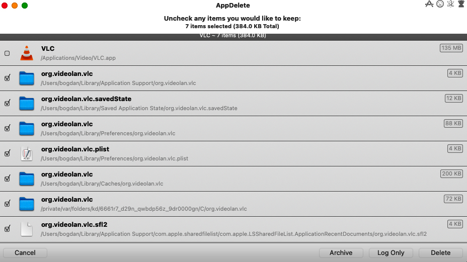

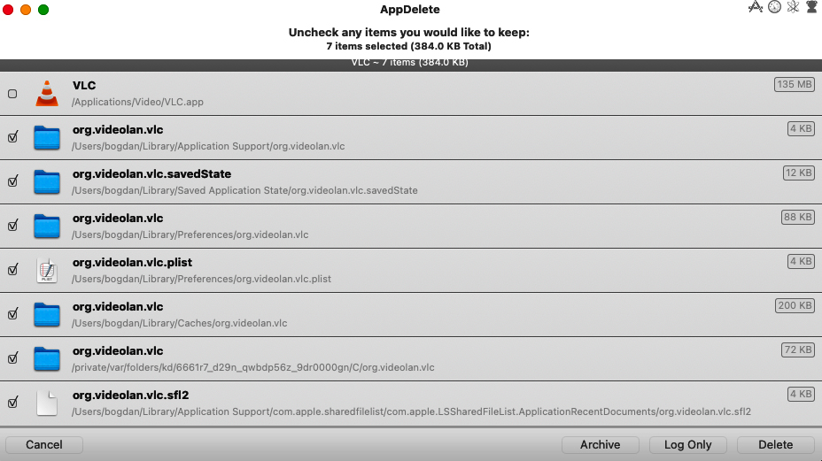

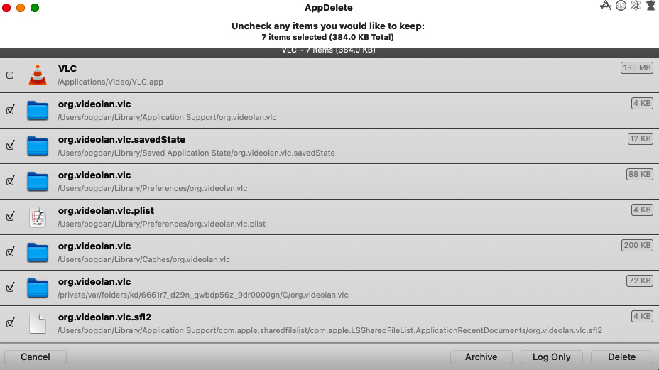

AppCleaner is a good & free app, but doesn’t find the garbage stored in /private/var/
I still use AppDelete (http://www.reggieashworth.com/appdelete.html)
Highfive!!! You are the man. It did the trick.
After using this app and reinstalling a pop up showed up asking if I would allow VLC to use my meta data. This did not show up previously. My guess is that at the very first time installing this app I selected the option not granting permission. That somewhere in a preference file this choice was saved and does not get deleted when uninstalling the regular way and it does get deleted using AppDelete.
