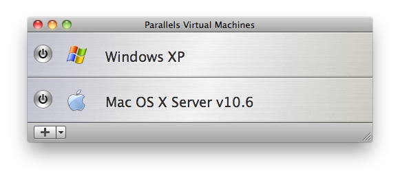

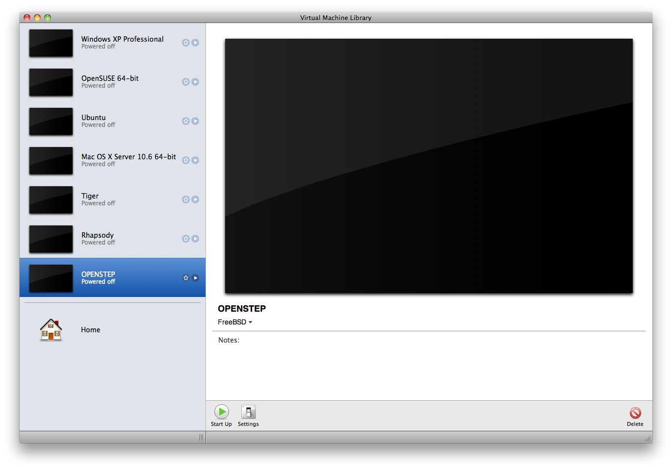

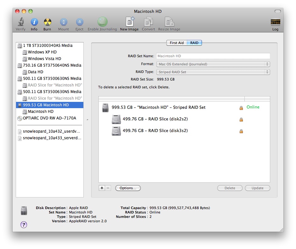

Some screenshots for your satisfaction:

As already said, both VMware (at least >=2) and Parallels >=3 work fine with software RAID0.
I've got several VMs on a software RAID0 array (although the applications themselves are installed on a single drive) and they work flawlessly.
I reckon you misunderstood nanofrog on this one, cause I really can't see a reason why this should not work.
