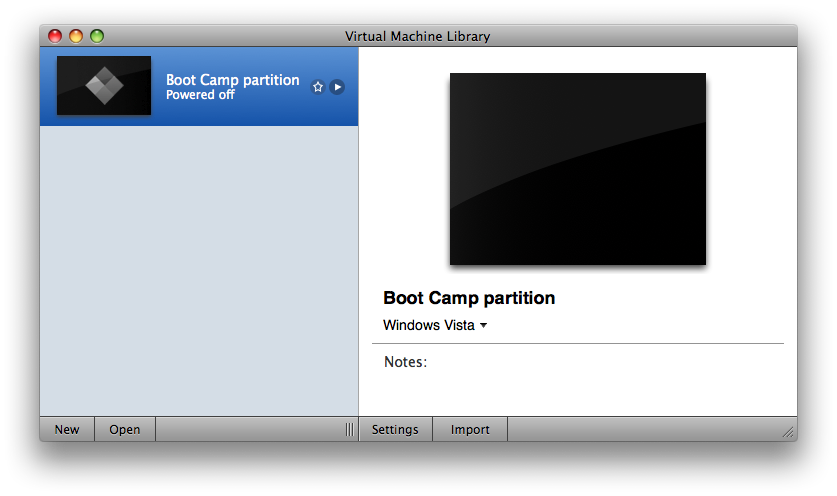

By pointing Fusion to the Boot Camp partition, it allows you to use the previously installed copy of windows as a virtual machine. It also allows you to go into windows without having to restart for those quick things, but still maintain Boot Camp for intensive things like games.
In your case, you'd have to delete the VM you made, and install Win7 using Boot Camp. Once the install is finished, open Fusion and it should list the Boot Camp Partition.
Like this:
