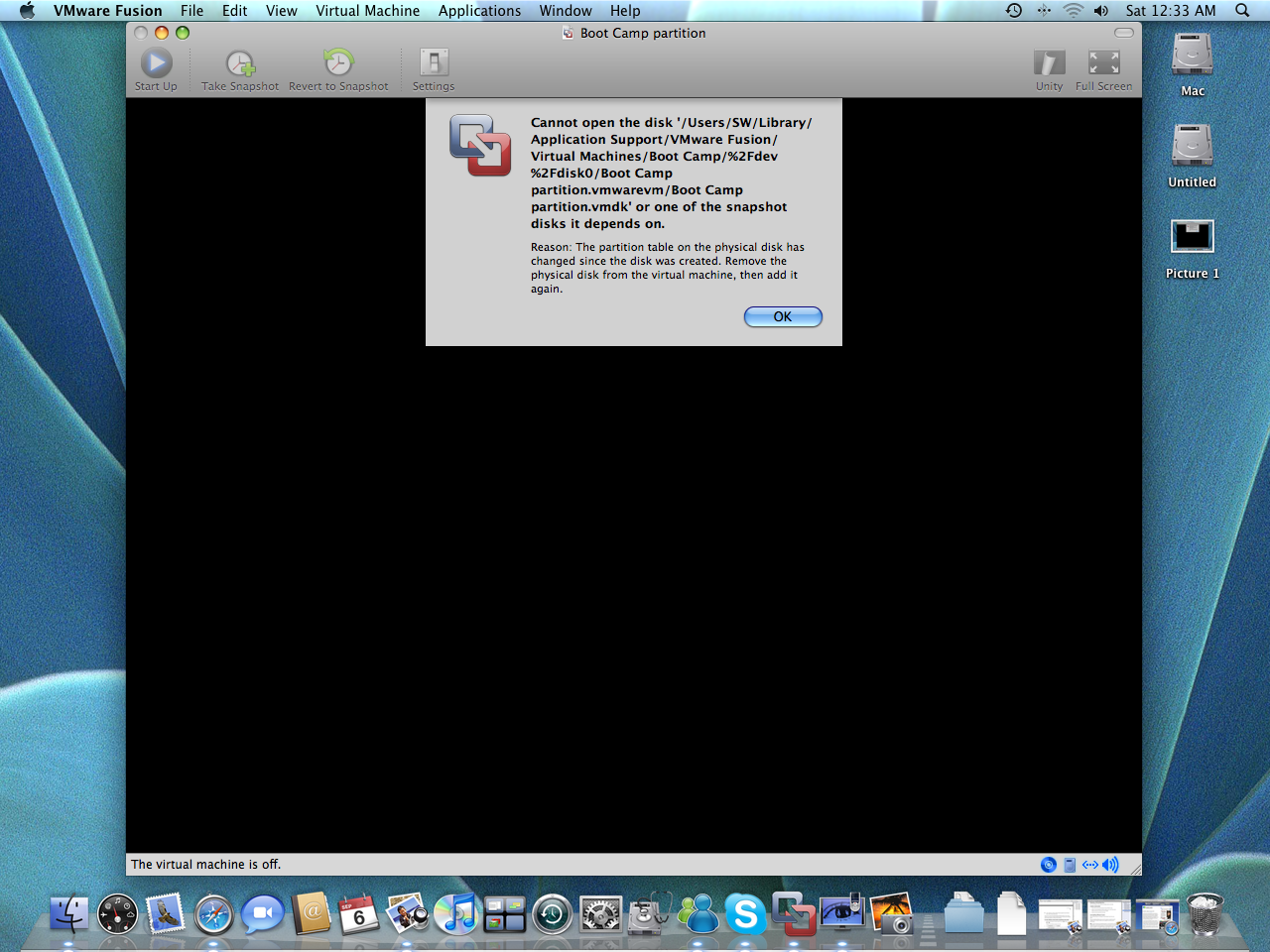

Hi,
I created boot camp and install XP Home with SP2. No problem running in boot camp.
However, when I install VM Funsion (1.1.3), when I run boot camp, it gives me this error. It also did not reconize the fireware and external device.
I install Vista Ultimate, it does not have sound.
Can any body help ??
Thanks.
Bootcamp and VMware Fusion are separate things. You can't share the bootcamp OS with the VMware OS. I think that's what you're trying to do. 😕
