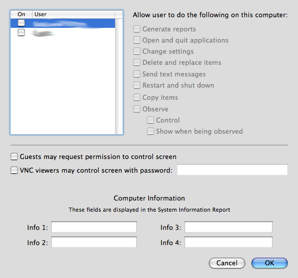

Btw you don't need a VNC server, just enable Apple Remote Desktop (System Preferences==>Sharing==>Apple Remote Desktop), and enter a password for VNC, and tick the "VNC clients may control screen" option when the attached screen comes up. I've never had any problems with this.

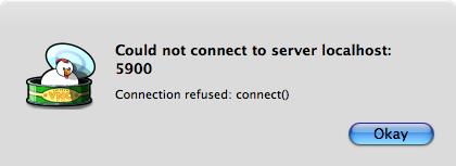

edit: i gtot rid of osxvnc on the mini turned on remote desktop made a password checked al lthe fields went to the macbook in chicken of the vnc added a server for the host i put that computers ip went to displat on put in the password and get this message "cennection refused: connect()
You got this error?
except that Localhost is the server you are connecting to, I got it when I tried to connect to myself with Apple Remote Desktop off,

Based on this too you are getting connection problems, I'm assuming you can actually play shared iTunes music not just see it in the sidebar?

edit: yeah that is the error i get^^
