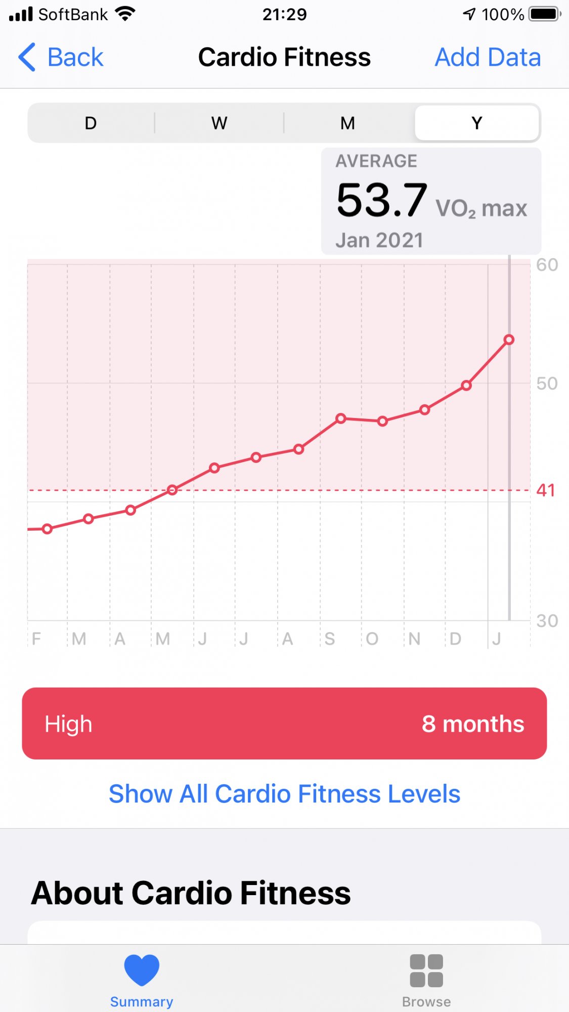

I've found VO2 Max to be very accurate and right in line with the readings I get from the Fitbit Charge 4 I wear on my other wrist.
I started doing daily 5 mile runs in February, 2020 and have been on a fairly steady incline since.

Are you showing a persistent heart rate in your workouts in the Activity app? This is essential. I was having problems with occasional intermittent dropped heart rate readings on my Series 4.
I switched to a sports loop band and wore it a little higher up on the wrist and have had solid HR readings ever since.

To get a reading for VO2 Max on my watch, I have to start an outdoor walk or outdoor run and do at least 20 minutes of walking/running (the workout can’t end for 20 minutes straight) to get a reading.
