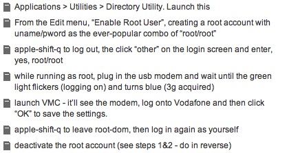

A(hopefully) better way of dealing...
As I had pretty much the same problems described here, I found a link (http://www.innoparticularorder.com/...cessary-problems-with-mac-osx-leopard-solved/) that seems to explain what the trouble is with the VMC s/w.
For the time, I just have uninstalled and reinstalled VMC for the 16th time in 5 months. Next time I hope that the way described in the link will do just fine instead of the uninstall/install chore. Wish You all the best!😀
U don't have to uninstall!
The thing i was referring to previously, simply just worked!😎
I was tired of the uninstall/reinstall thing which sure got more time of me...
And to make it more transparent, here's a short excerpt from the article. For more info, go read it all!
