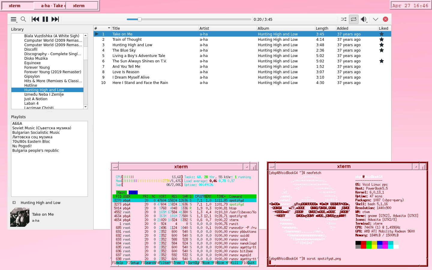

I have compiled Spotify-Qt on my PowerBook G4 which is a third-party client and it works nicely for people who want something more than a TUI one.
That sounds great. I could only get the front end working on mine so it could control Spotify on another device. I couldn't get spotifyd to work locally. On other devices I have had good results with ncspot but I can't find a ppc version of it.
What issue were you having with spotifyd? This is what I also use and it's available in the package repository so it was overall quite easy to set up.
I also tried ncspot but it failed when compiling one of its dependencies.
I couldn't work out where to actually put the config file and how to add the username and password so that it would actually run and connect to Spotify. I had the same issue on an i386 device running freeBSD and couldn't solve it. So cool to hear that you have done it on a very similar device to mine. (a 2005 15" 1.67 PBG4 running Void)
Reactions: scarlett7447
Thanks! It runs really nicely actually, even on my iBook G3. About your issue, you should check out the wiki - https://docs.spotifyd.rs/config/File.html
They have detailed instructions on how to set it up + an example config file.
Thanks for the tip, I will try again. Last time I couldn't work out which directory to put the config file in and so it wasn't picked up by spotifyd.

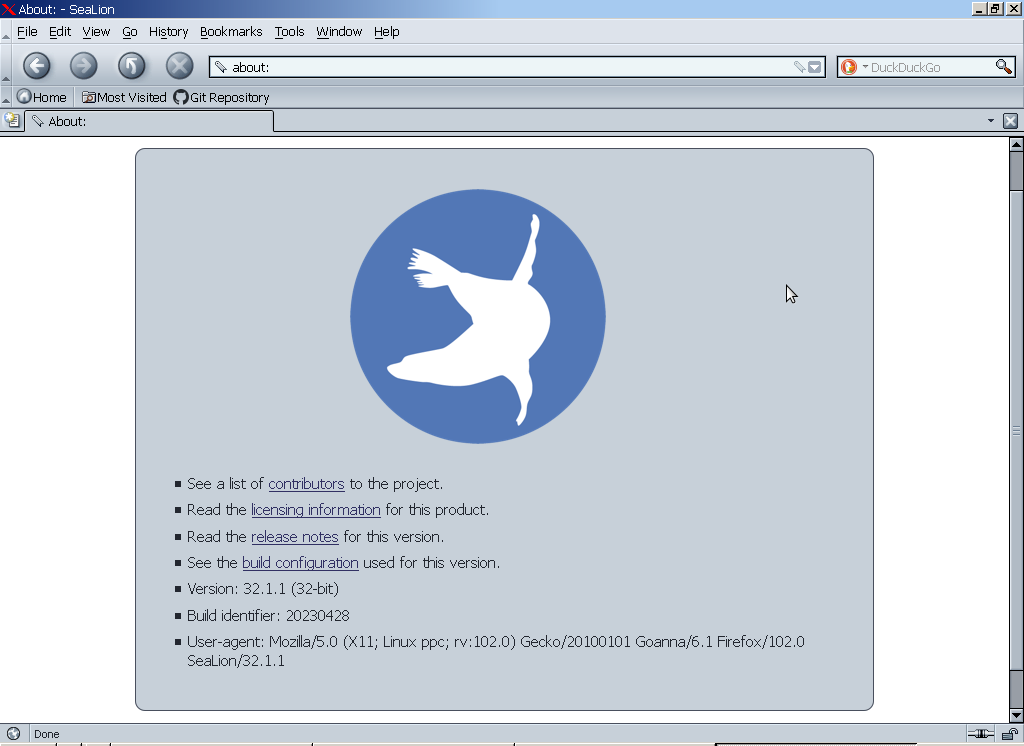

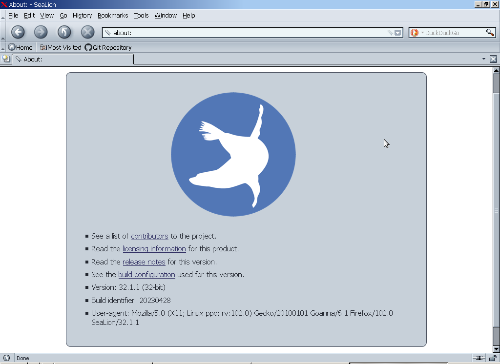

Along with my build for OS X 10.7+, i've also just built a ppc32 build of SeaLion for Void and Debian 11.
No installer. Just extract and run (or copy to /opt and create your own .desktop file).
Can be found here: https://github.com/wicknix/SeaLion/releases
Sea lion..?
..I didn't even know of such a thing. Is this a port or something made from scratch, wick?
Oops - better go look at the link..might find out.
Nope - none the wiser.
Are ya gonna put this in the garden?

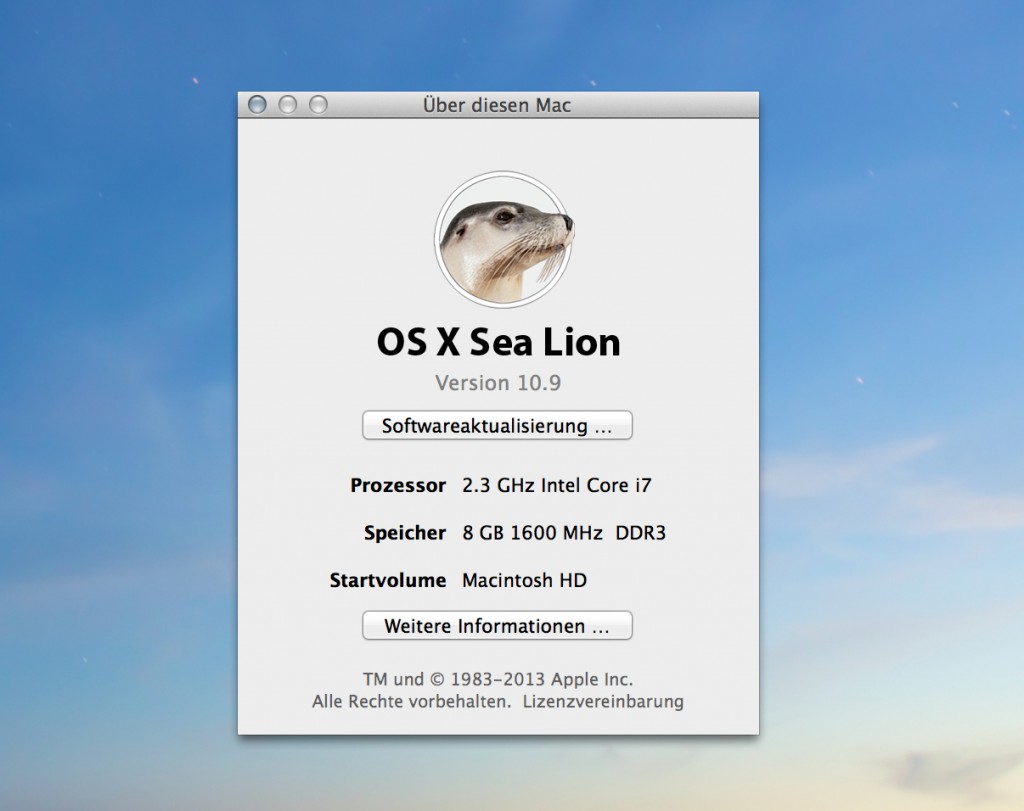

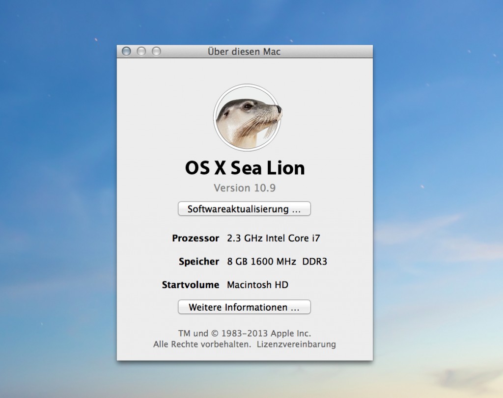

Yes, SeaLion because...
A) It's based off of SeaMonkey's browser component.
B) It runs on OS X Lion or higher. (and now ppc32 linux)
C) OS X 10.9 was briefly called Sea Lion. (a joke...or was it?)
So i thought the name was fitting. 🙂
