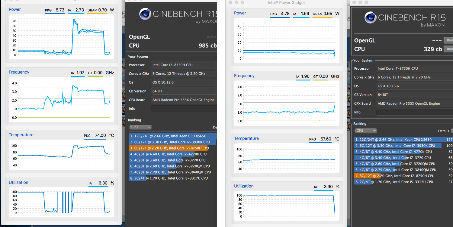

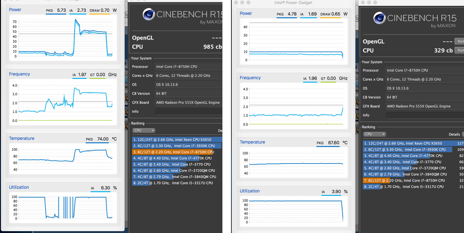

It seems to work for me.

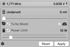

For giggles, I set the power limit to 10w and here's the result
The first image is with Volt not doing any limiting, i.e., I disabled the Power Limit checkbox.
Second test is setting it to a ludicrously low setting, just to avoid any confusion 🙂
As you can see the numbers don't lie
You might as well get a 12" MacBook if you just want a 1Ghz laptop
Just for reference, my almost 5 year old 13" MBP Late 2013 with the i5-4258U 2C/4T @ 2,4Ghz has a Cinebench score of 244 points without any power/wattage caps.
But even with a score of 244 it is still perfectly capable for office work, e-mails, browsing, video streaming, music listening, etc without any slowdowns, so imagine the battery life you could get on these new models with a wattage limit of 10W while doing normal non-intensive office work! 😱
