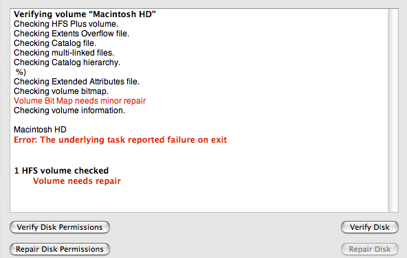

D DA-Steve macrumors regular Original poster Aug 16, 2007 #1 Just ran "verify disk" in disk utilities and got this Any ideas on what i can do to fix it? this was after i ran repair disk permissions Attachments Picture 2.png 40.8 KB · Views: 222
CanadaRAM macrumors G5 Aug 16, 2007 #2 Simple - just boot from your OSX DVD (Command-C during boot up) and run Disk ujtility from the DVD (under the Utilities menu) and do a Repair Disk Problem solved. The thing is: Disk utility cannot Repair a disk, while the machine is booted from that disk. That's where the 'failure on exit' thing comes from
D DA-Steve macrumors regular Original poster Aug 16, 2007 #3 CanadaRAM said: Simple - just boot from your OSX DVD (Command-C during boot up) and run Disk ujtility from the DVD (under the Utilities menu) and do a Repair Disk Problem solved. The thing is: Disk utility cannot Repair a disk, while the machine is booted from that disk. That's where the 'failure on exit' thing comes from Click to expand... wow that was fast hehe.. thanks mate ill give it a go!

MisterMe macrumors G4 Jun 4, 2008 #6 Use File System Check at the UNIX command prompt Restart your Mac in Single-User Mode. Run File System Check: Restart. Press [ cmd ]+[ s ] until the command prompt appears. Type fsck -fy. When you get back the command prompt, repeat Step 3 until there are no additional repairs. Type exit.

Sun Baked macrumors G5 Jun 4, 2008 #11 yanksfan17994 said: how do i do this? Click to expand... You already quoted the directions. fsck is file system check --- Funny thing is -- click on desktop -- go to help -- type 'single user' Get this To start up in single-user mode: Choose Apple menu > Restart, or press the power button if the computer is turned off. 1. Press Command-S as the computer starts up. 2. The computer screen is black with standard white text. You can now run the UNIX commands that you want. Click to expand... When you go into single user mode, there are directions on the screen for using fsck.
