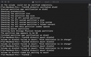

Hi, tried your instruction but i keep getting stuck getting it mounted back. Any help plzz.....

You could try this:
Fix corrupted exFAT disk macOS/OSX
from the Terminal:
diskutil list
The volumes listed should show your disk ("rdisk2s1") and possibly its partitions.
Then, copy paste this (replace "disk2") in the example below with your disk's or partition's name (of course, remove "(but your disk)").
sudo ps -ax | grep disk2 (but your disk)
you should get the process number keeping your disk busy:
13699 ?? 11:52.83 /System/Library/Filesystems/hfs.fs/Contents/Resources/./fsck_hfs -y /dev/disk2s2
Then execute:
sudo kill 13699
In the example above, "13699" refers to the process currently busy, but it should be a different number on your machine.
After killing the process, the drive should mount, with a Finder's warning.
