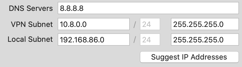

I just used the defaults that OpenVPN Enabler added in when I clicked "Suggest IP Addresses." The VPN itself works great; I just can't do Screen Sharing / VNC, which is super annoying.

When connected to your VPN server, you will be able to access other network devices via their standard 192 LAN IPs. But to connect to the device the VPN server is running on, you will need to connect to a 10.8.x,x IP. IF you dig into the logs, you should be able to determine what IP the server device is getting from the VPN server. Or just try addresses starting at 10.8.0.1 and working up.

That worked! Thanks so much for taking the time to explain it to me. And thanks for being patient with the fact that I hijacked your thread, haha. Thanks again!
