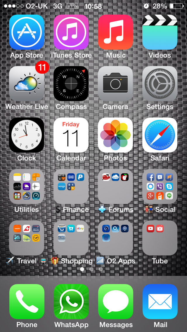

But this VPN (Virtual Private Network) stays ON on my iPhone 5. I turn if OFF and in a matter of seconds it turns itself ON! Any suggestion how to get read of this? Thanks.

I use vpn on my iPhone but never had a problem turning it off... That's real weird... Is this hapening on wifi and 4/G?

On both, 3G and wifi! Only started the last few days and just won't go away! Could this result in more battery consumation?

If it's only just started, then it may be software related...I'd give a restore a shot. As long as you have backups, then you've got nothing to lose by trying.
I had the same issue on my iPad. I found that there is another VPN setting in the General Settings area. Scroll done to the bottom of General and you should see a VPN option that says connected. Select this and look at the choose configuration area to see if Connect on Demand is turned on. With this on any time I would use an app that connected to the net the VPN would turn back on. Once I turned Connect on Demand off all is fine. Hope that helps.

go to your settings > general > VPN. Now tap the little blue arrow next to 'name vpn' and switch off the 'Connect On Demand'.

Thanks a lot. It works. I was having the same issue on iPhone 7 plus (Need to connect on blue dot next to VPN name and then options comes up)
I found a second solution, specific to my VPN app and separate from "Connect on Demand" (which I keep OFF). I'm using proXPN's VPN client app. The first setting inside the app is "Connect to proXPN". I turned that OFF. Leave it off. Everything now works as desired. VPN doesn't attempt to connect unless I tell it to inside Settings: VPN.

There are two places where VPN is addressed. One is directly under Settings. The other one is under Settings/General. You must click on Settings/General/VPN. Then, click on the blue information bubble next to your VPN service provider.
Then, turn off "Connect On Demand" as shown below. You should be good to go.
