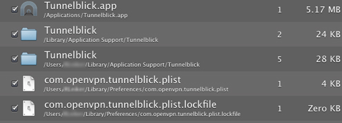

I'm not sure what the new version of TB is but v3.1.7 works for me in ML. As fickle as my VPN configuration is, I don't fix what isn't broke.
Before upgrading, I first copied all my keychain info form the old system to ML, then I copied the following files to ML (including the app):
