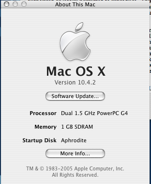

Oh, and here's a quick screenshot I had taken before the Cube died... help me bring it back to its former glory!
