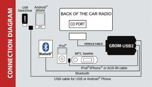

You can get Bluetooth receivers which replace the factory-installed dock connector. You can then either use Bluetooth or connect your iPhone via USB to the box to charge it and play music. Works with Android phones or USB flash drives, too.
