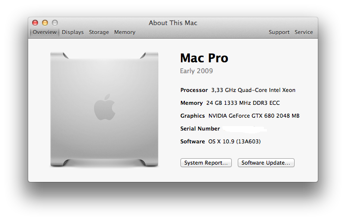

No problem at all: that's what I'm using in my quad 2009 Mac Pro, while I wait for the 6-core's price to come down.
