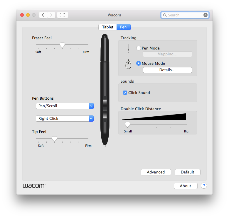

I found a partial answer to my issue, I installed the driver only on my OS X 10.10 rMBP and there I also have
under System Preferences , "Handwriting" , "Ink" but also a PrefPane Wacom where I can tweak the pen settings.
Under OS X 10.5 I also have a PrefPane "PenTablet" but it only shows " No supported pentablet found on this system"
