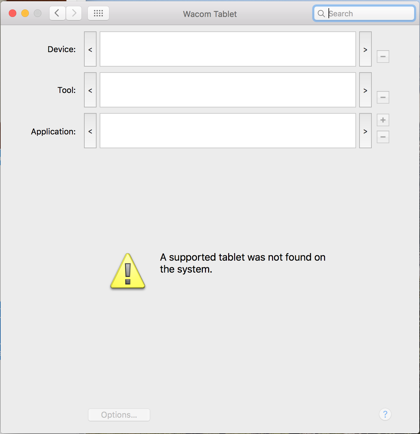

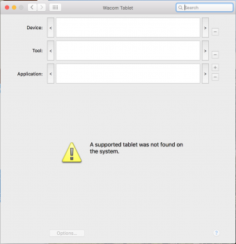

I'm on PB 5 and my 13" Cintiq is connected and recognized, but the System Preferences pane says "A supported tablet was not found on this system."
I have the latest driver on the Wacom website, WacomTablet_6.3.13w3.
Is anyone on El Cap able to change the preferences for their tablet?
Edit: I've tried installing it over an existing installation, and also uninstalling it before uninstalling it. Neither worked.

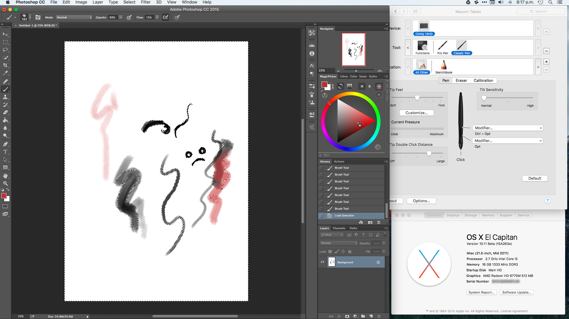

Clarifying question: does your System Preferences Wacom panel recognize the tablet? I can draw in Photoshop, even with pressure sensitivity, but I can't configure the physical buttons on the tablet (or anything else one might do in SysPrefs).
Yup, everything is working 100% as normal in 6.3.14-2, everything detected and customisable, screen overlays etc all working right.
Dang. Well, pretty jealous. I tried a whole bunch of things, and simply couldn't get it to work.
Aside from our individual software differences (which could theoretically cause problems, I suppose), I am on a 2015 12" Macbook (and 2013 Macbook Air) running PB5, which is build 15A262e, rather than 15A263e (which is what you're on).
If anyone else was having my problems, and did any concrete steps to fix it, let me know! I'd love to get the tablet up and running again 🙂
