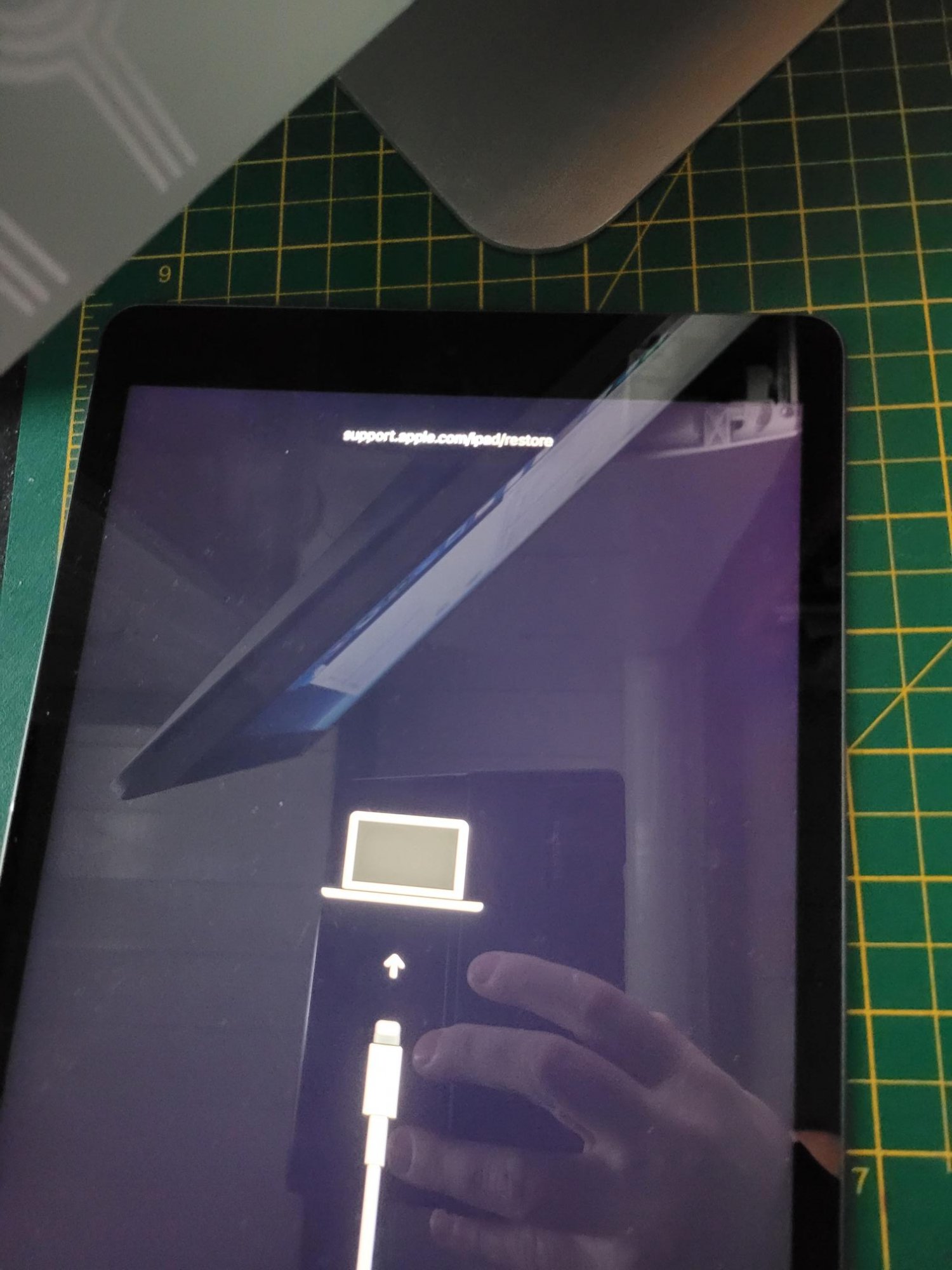

I have an iPad 7th gen which is stuck in loop, Apple logo, off, Apple logo, off etc

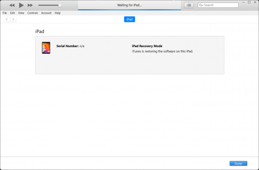

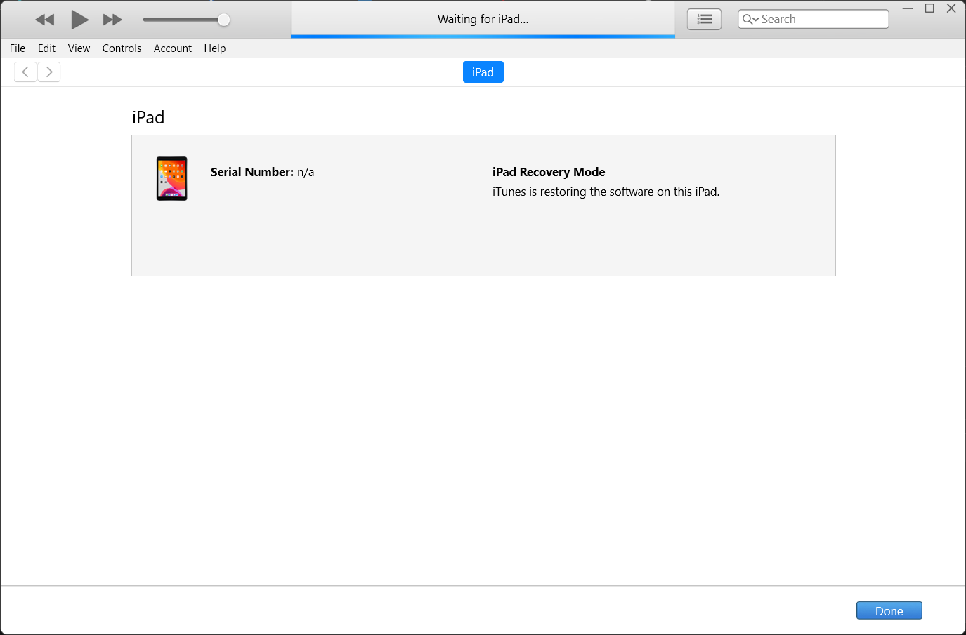

I have tried update in iTunes but it fails with error 4013.
I can get the iPad into DFU mode and Restore mode but when trying restore it gets stuck on "Waiting for iPad" in iTunes, on the Ipad it shows cable and computer.

It’s not something I’ve experienced but check that the lightning port is clear of dust, try a different cable, and a different computer in case the USB port isn’t working correctly. Try downloading the .ipsw file and doing a manual restore.
Also, try plugging in some earphones. It sounds weird, but it has worked for a few people according to the following thread. There are some more suggestions on there as well -
