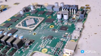

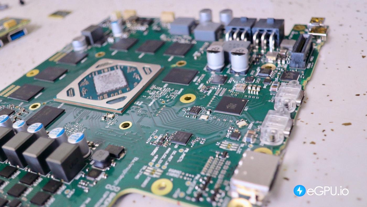

Found a teardown of Blackmagic eGPU and board traces indicate that the HDMI port is hooked to the GPU on the custom board they build. ( TB controller and GPU are all on the same board. )
[ image attached. ]
https://egpu.io/forums/thunderbolt-...-egpu-radeon-pro-580-thunderbolt-3-enclosure/
lower right of board image here is the HDMI port and the 4 pairs of traces coming from GPU (framed by metal square on board) between the two.
This Blackmagic eGPU isn't purely a compute GPU, but it is heavily skewed that way. ( one and only one display can be driven. Even a single port Macbook can drive two. ).

The question was more so which GPU is running the output for each of those ports.
I was under the impression that when you select the eGPU as your graphics option, that all GPU functions are shifted to it, and the internal is effectively powered down, but maybe that changes with the app-by-app options for tying apps to the eGPU.
So I think where some of the confusion comes from;
In macbook world, where the laptop had an intel CPU with embedded GPU, and an embedded third party mobile GPU, both GPU's output ran to a mux chip and then to the screen. So Either/Or GPUs could send their outputs to the same screen. It seems like a some reviewers expected similar behaviour from their eGPU boxes when connected to their laptops/imacs. Where they would be able to select the external unit and expect an accelerated 'drawing' on their primary screen. Which is not the case. Under some circumstances it seems that accelerated 'drawing' was only available with a secondary screen hooked up to the eGPU.
This is moot for a headless macpro with no primary screen.
But it does suggest that the eGPU is meant more as an app specific co-processor, ( or potentially an iDockPro ™ )rather than providing any update utility down the road. It feels like a lot of folks have this misconception ?
