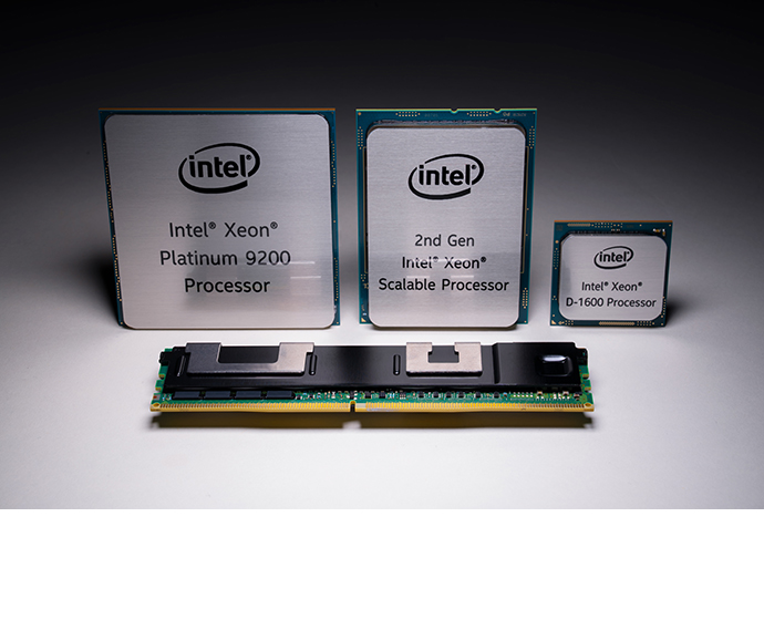

Up to 56 cores!!!! That must be one big chip..
From Intel press kit
The 9200 is the AP package version . It is huge . After putting that on a logic board with 12 DIMM slots clustered around it , a relatively very large chunk of horizontal space will be gone. Not going to see that package normally coupled to several generic standard full length , high power ( volume) PCIe slots . ( probably more often to m.2 , OCP NIC , FPGA card , 1-2 compute card , or bridge to PCI-e cage )
WWOOOOOWWWWWWWW!!!!
That’s one huge chip! It will have to offer one hell of a performance advantage for the rack space the machines that will use them will take up!
I can see why their is no chance what so ever any new Mac will use them! Pro or server.

WWOOOOOWWWWWWWW!!!!
I'd imagine that interns of total space per core, accounting for an entire package (case/racks, all of it), the 9200 series will be the best way to go. It better be one really well cooled room though, holy moly. And yeah, Macs aren't likely to use the scalable line regardless (though I wish they would).
