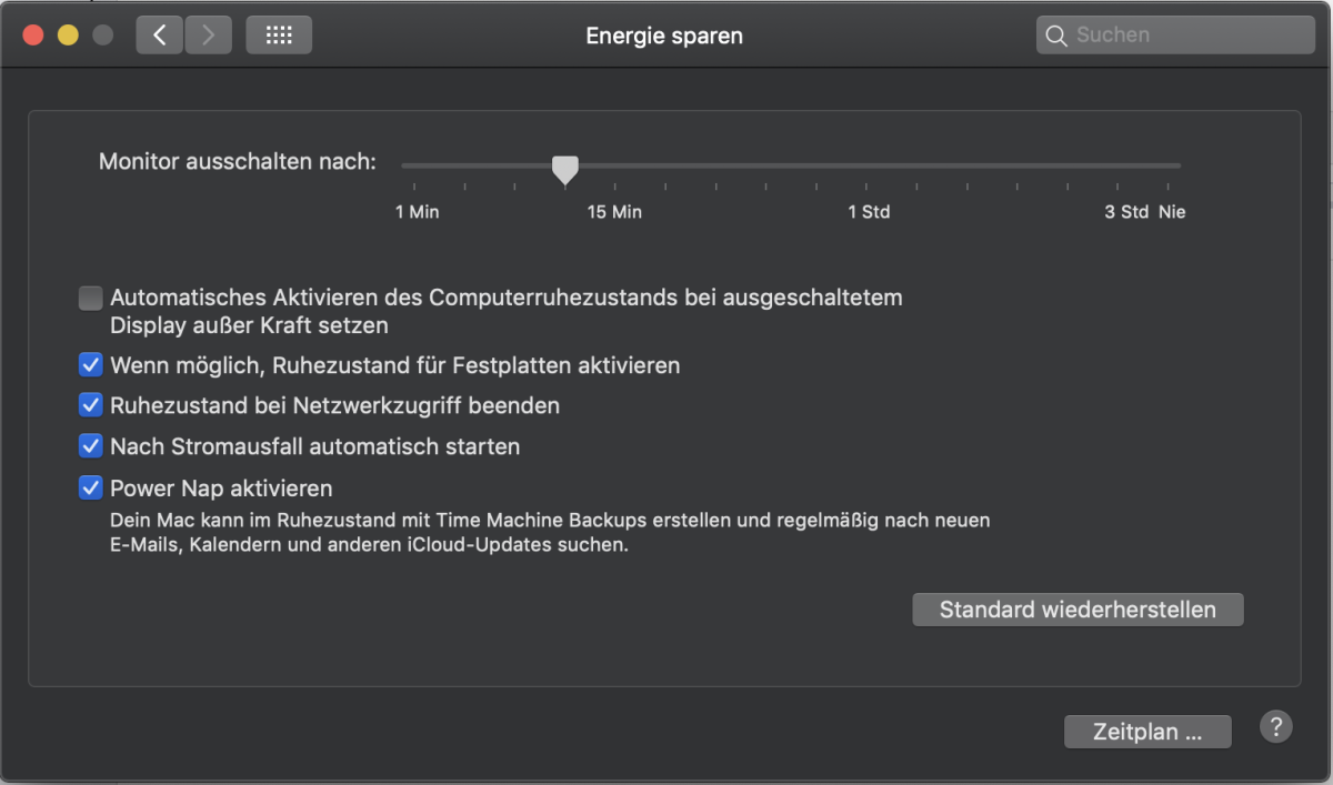

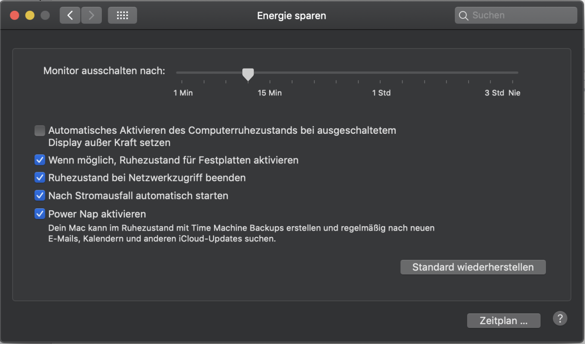

The iMac (firewall is deactivated) should be woken up from hibernation (in German "Ruhezustand" -> sleepmode?!) using Wake on Lan via Fritzbox. After that, Steam (iMac) should be accessed via SteamLink (iPad) (which works perfect with a Windows laptop). The required settings in the "Energy saving" menu have been made, see Image_1

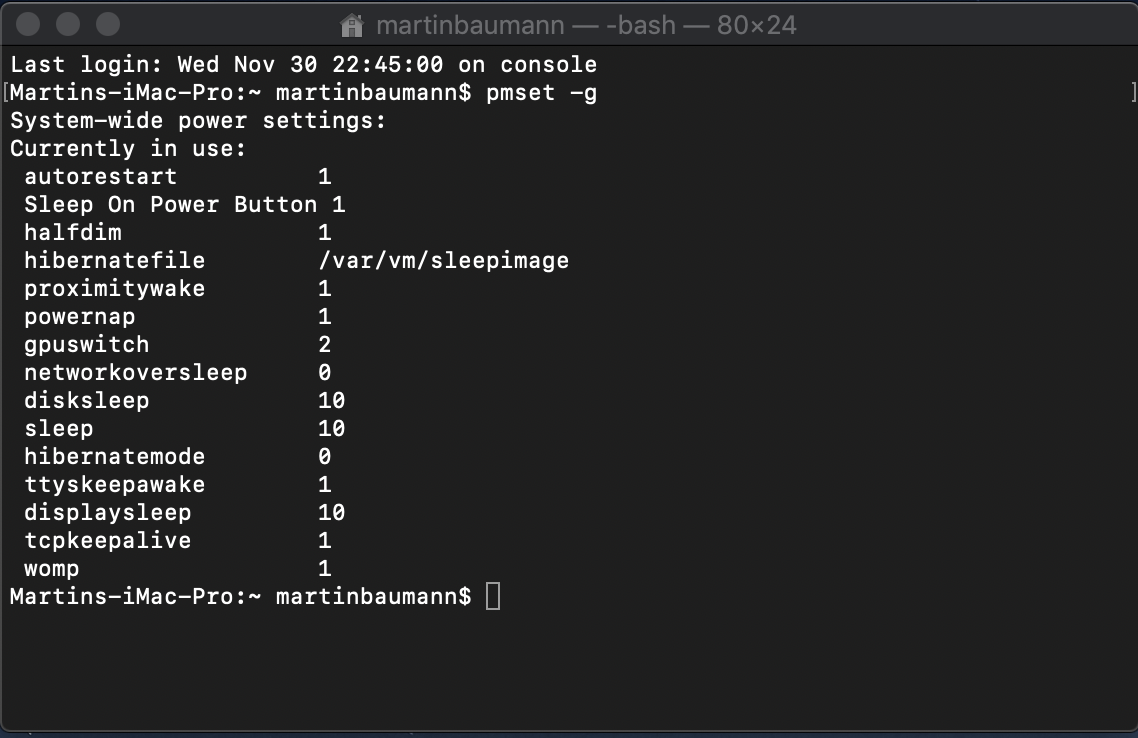

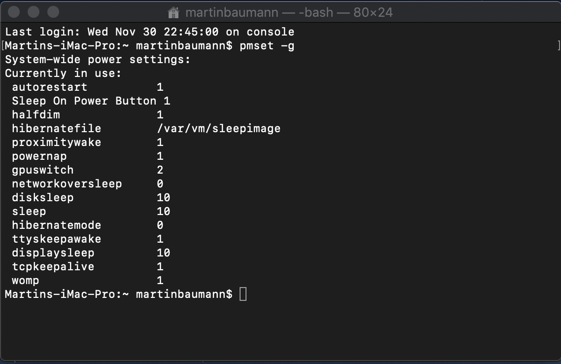

#2 pmset -g showing me the "hibernation mode", see Image_2. The Mac is not in a deep sleep, should actually work.
