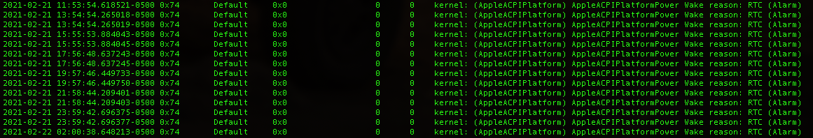

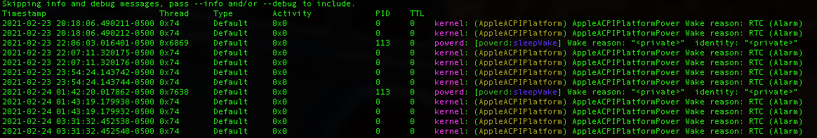

MP5,1 running 10.14.6 (18G8022) keeps waking up every two hours due to RTC (Alarm). Logs show the following for example:
Can't seem to determine the root cause. I've just disabled 'Wake for network access' and will continue to test. Any other suggestions?
Edit: interestingly enough, my MP3,1 running 10.15.7 also wakes every 2 hours. Commonality between the two is wake for network access being enabled. I do have to leave that on with the MP3,1 though as it functions as a file server in another room.

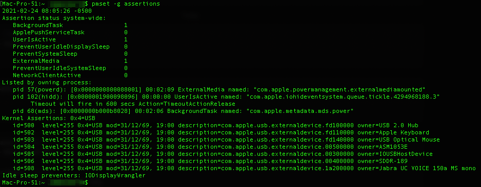

What does your pmset -g assertions say?

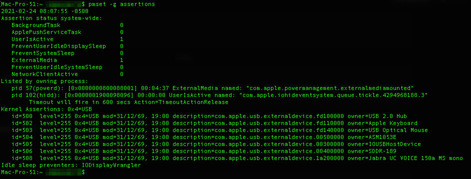

The assertions change depending on when the command is entered in terminal as sometimes, background processes start and end during the query.
Here's what it reports almost right after reboot:
And 30 seconds later:
