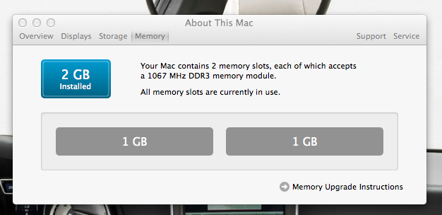

Hey Guys,
I wanna update my memory because I jus bought an iMac and it has 8GB of RAM. I can see how my Macbook is much slower (and older). Is it possible to update it to 8 GB or at least 4? What is the max?
I attached a picture...

Definitely upgrade the RAM to 8GB. If you can do both, it's a new lease on life. If you can only do one thing, do the RAM.
If you don't, you'll have memory swapping to an SSD which is bad for SSDs (shortens life).

There's nothing else that you need to install, no settings to change when you simply change out the memory sticks.
Another OWC video shows exactly how to open up your MacBook and change memory, but the hard drive swap, should you choose to do that, will get you inside, too - and the memory sticks will be right there, too.
