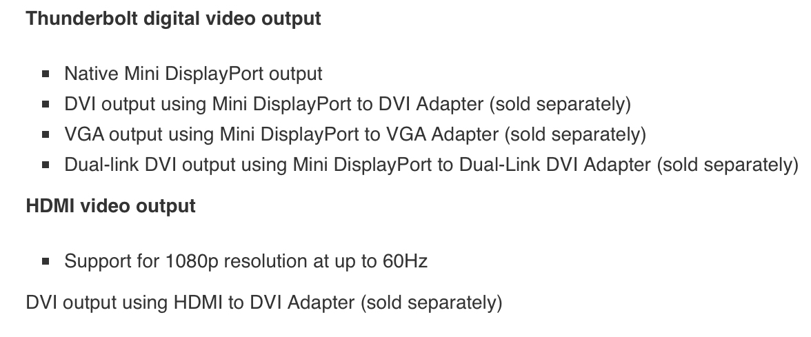

You could use the last option in thunderbolt list if your display is dual link dvi.

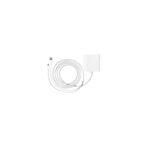

Update: I found this official adaptor from Apple: https://support.apple.com/en-gb/HT204149
That looks like it might not come cheap, but would a 3rd party powered mini display port to dvi dual link cable work just as well, or is this one of those things that Apple kept to itself?
Update 2: Wow, didn't think these adaptors would be so pricey, especially now they are essentially obsolete tech - cheapest (used!) was about £40. Could probably buy a decent Display Port switcher for half that, then just have a straight forward Mini Display Port to Display Port cable from the Mini to the Display Port switcher. Options...
Quote: "would a 3rd party powered mini display port to dvi dual link cable work just as well".
Probably not.
Back in the the era of your mini there were lots of people trying to connect old Dual-Link DVI Apple displays to their TB1/2 Macs, and very few of the 3rd party convertors worked. Lots were tested and lots failed.
Your BenQ monitor may not be as fussy as an Apple Display (but your Mac probably is...)
If the cable/adapter isn't Dual link then the best resolution the monitor would show is 1080.
I'm going to -guess- that the "Apple Mini DisplayPort to Dual-Link DVI Adapter" is the one that you need. Might as well spend the money if you want to use the display.
