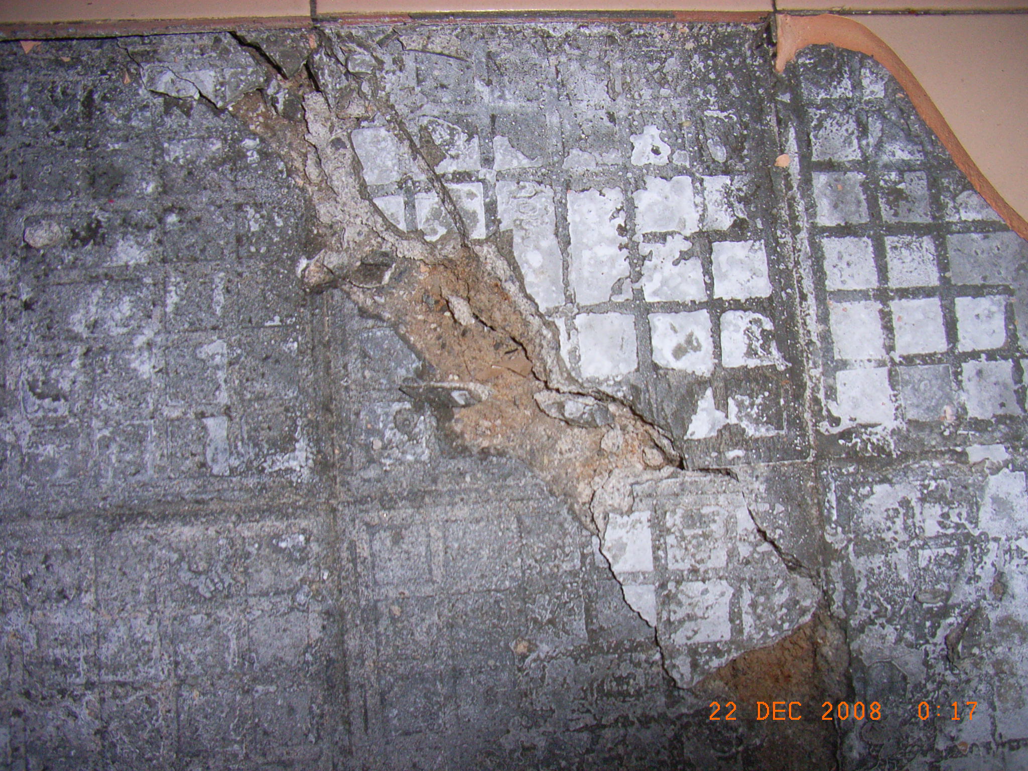

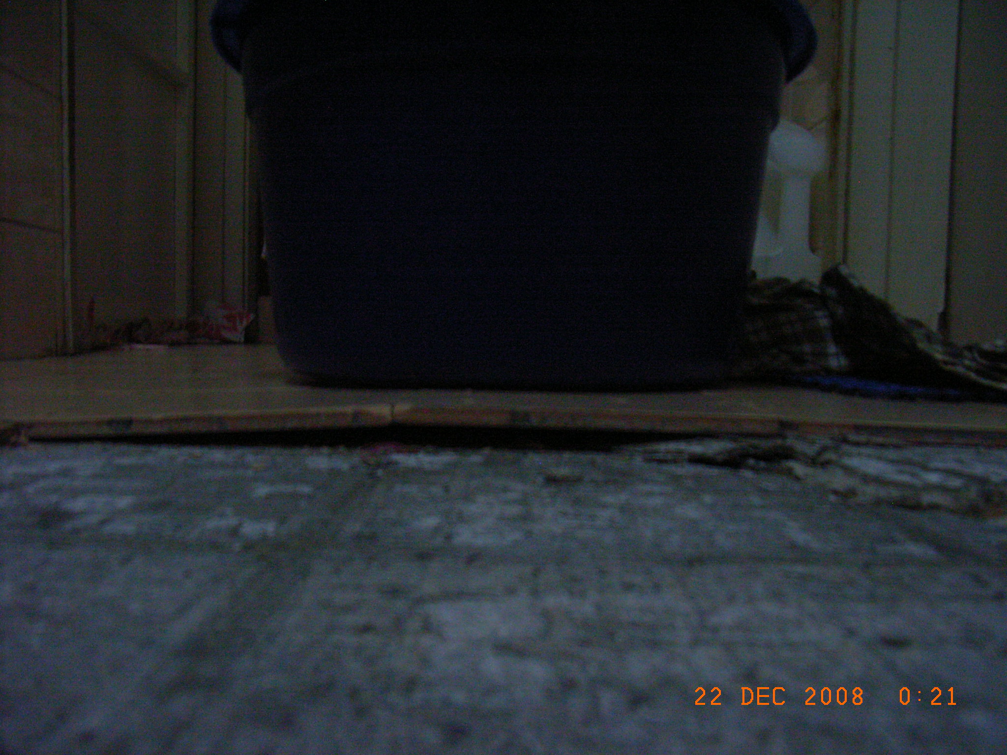

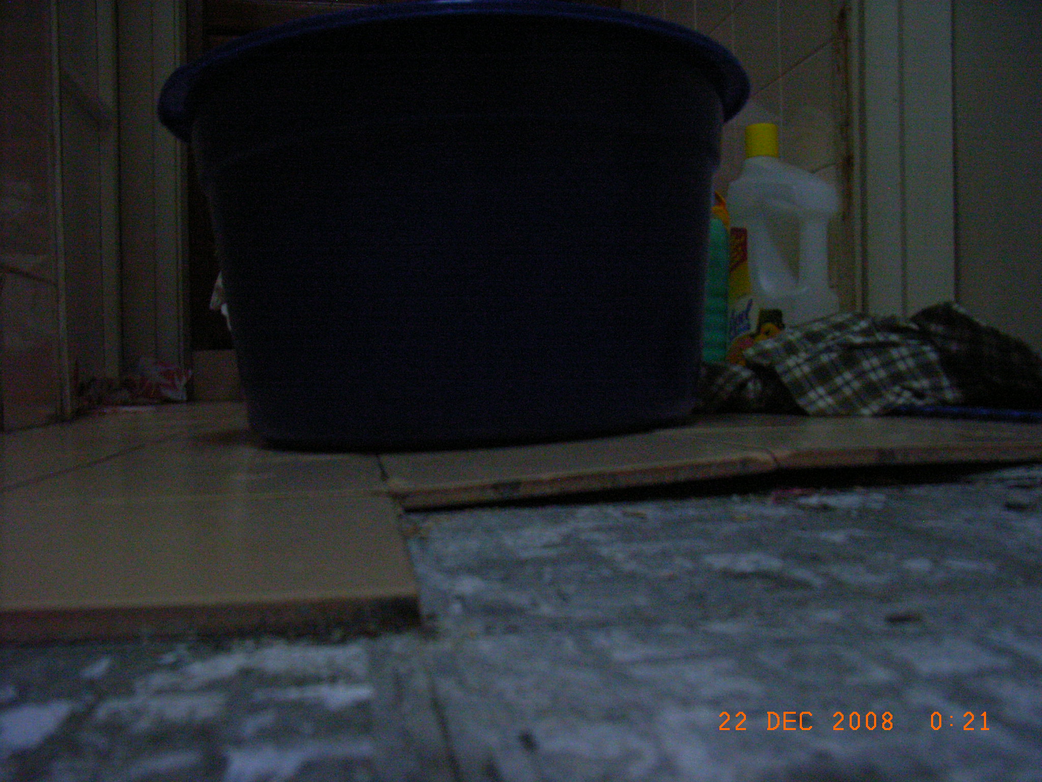

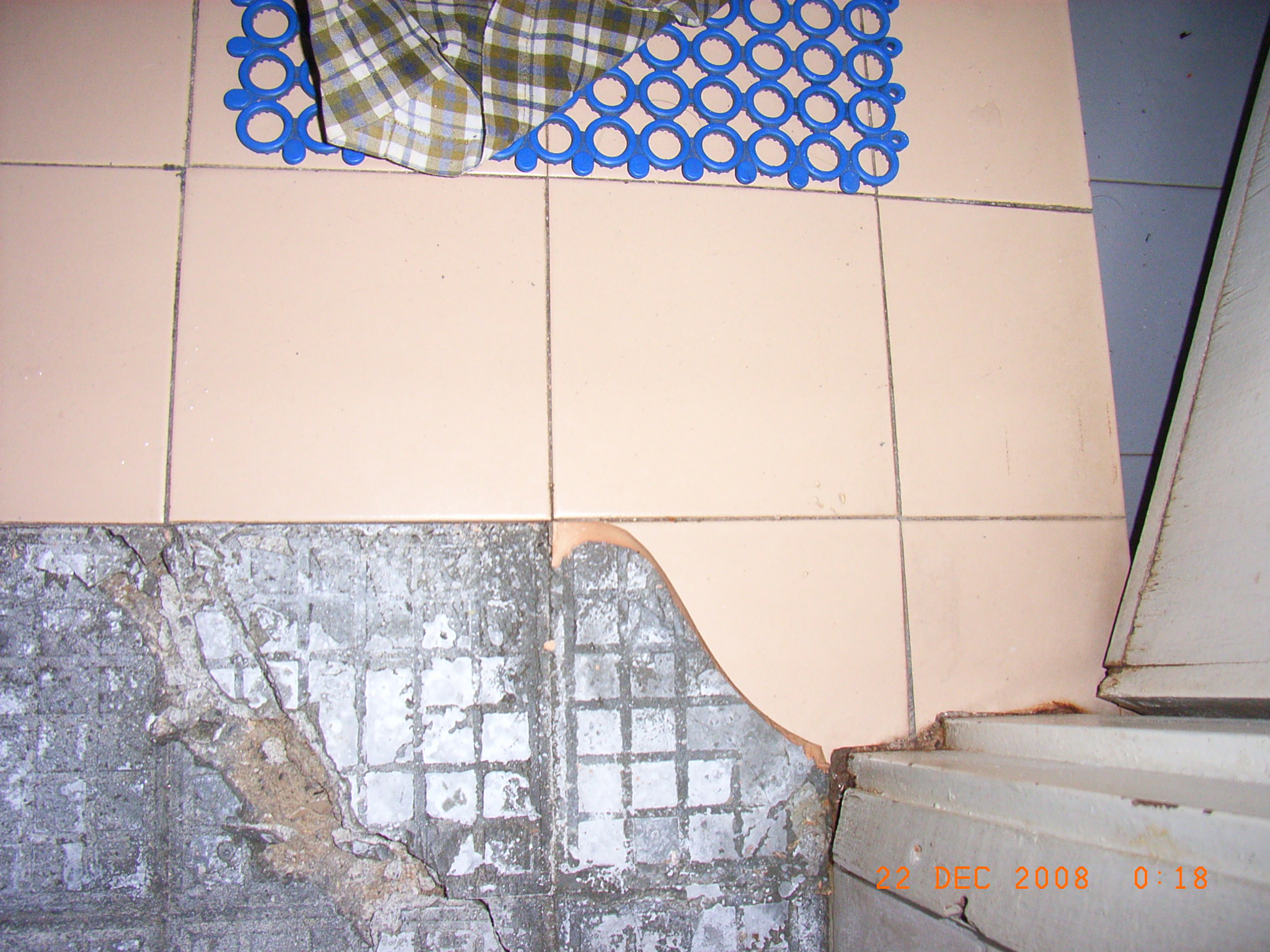

Thanks! Can you look at some more pictures? I have taken some pictures of the cracks running with and under the pop ups. The floor appears to be uneven. It's quite near the toilet. The flooring is about 18 years old. You can see the toilet floor on the right side in the 2nd picture. It may be possible that water might seep into the foundation. Also, just about 6 1/2 feet diagonally away, it's a drain at the back of our house, water has mysteriously disappeared under the cracks of the drain.
1. So this might be water seeping into the foundation again?
You can also see the surviving tiles in the last two pictures. It appears that there is about 1 cm gap at the peak between the tiles and the cement/concrete.
2. Does this strengthen the foundation problem theory - cracks and uneven flooring?
3. When you say bore a hole, how big is this hole normally be to warrant checking of settling or water problem?
4. What's settling problem?
Thank so much. Will be anxiously waiting for your reply.

Settling, is when either through time or water the dirt under something begins to compact or sink if it had organic material in it, leaving space. The concrete foundations, of most houses, has little to no wire/rebar in it for strength and will crack and move over time. If the water has been getting under the slab, it will create a gap under the concrete and the slab will crack.
The hole to bore, is about 5" in diameter, and can be filled in with concrete real easy. They hook a drill up to it with anchors and bore through the concrete and either use a mirror and light or a camera to look if there is sufficient area.
Depending on the company, repairs will cost a little or a lot. Most is to remove the old, then re-pour.
The cheaper alternative, which really doesn't address the problem, is to glue and anchor 1/2" plywood down, then lay new tile over it. As I said, it is cheaper, but doesn't really fix it, and if there is active water leaking underneath, it will do other damage as well. Active water, being from water lines rather than sewer or rain.
I would get a contractor out to look at it. Most will give free estimates to let you know the options.
